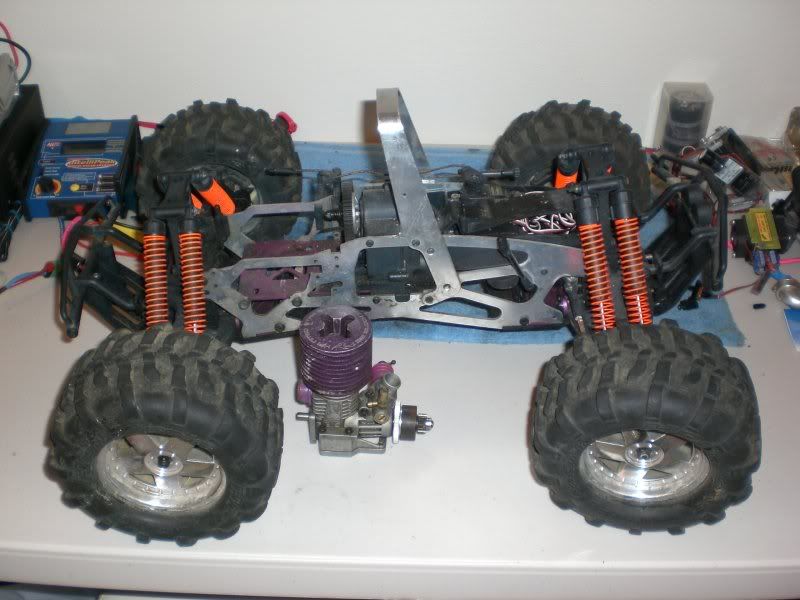

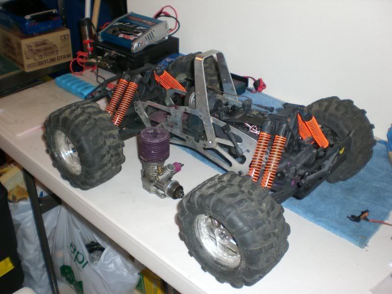

oops - i forgot, i have pics of the sav as it is =)

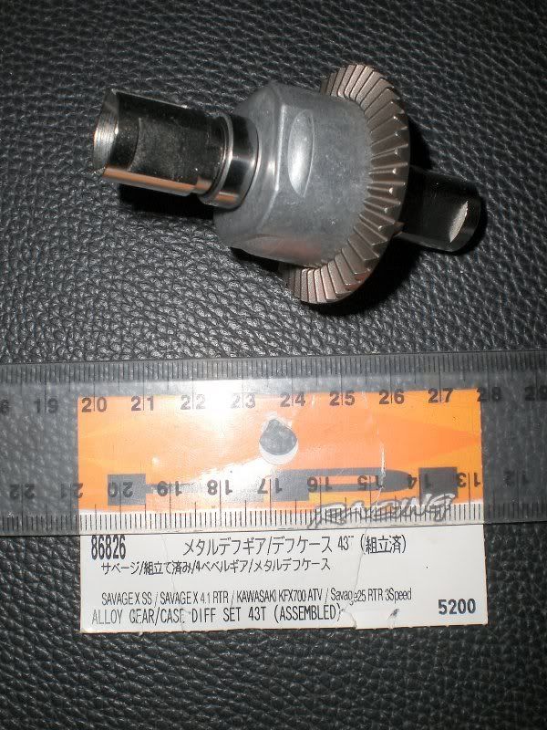

btw... been looking at two of these instead of just getting the diff cases? i assume this would cover the diff case problem? =)
"ALLOY GEAR/CASE DIFF SET 43T (ASSEMBLED)"
http://www.hpieurope.com/piw.php?lang=en&partNo=86826

Not sure if the losi TiNi will fit or not. Get the diff you pictured and the bulk heads by flm and you will be fine. Now the shimming is just pressing the crown gear tightly to the center diff gear. As long as there is no slop you should be fine and the diffs will last a good amount of time. The most important thing is shimming. Most people just throw the diffs in and call it good and with nitro it is ok but still not good. With BL it will shred the gears if not shimmed correctly.

for now tho - i picked up the last diff one of the LHS had in stock - was a bonus, as i won a drift comp a short while back, and scored a 50 dollar gift voucher, so it really only costed me $22! =)

I think the whole alloy diff case thing is to prevent the outer diff case flexing when the diff loads up - usually resulting a breaking a tooth or two off the diff pinion. So not alloy diff cup, but the out case (or the whole bulkhead for the newwer savage style)

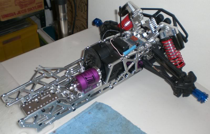

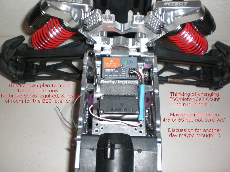

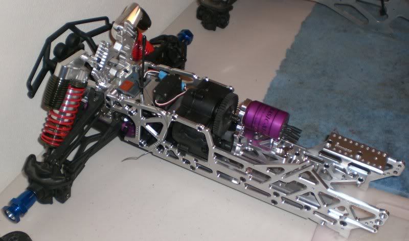

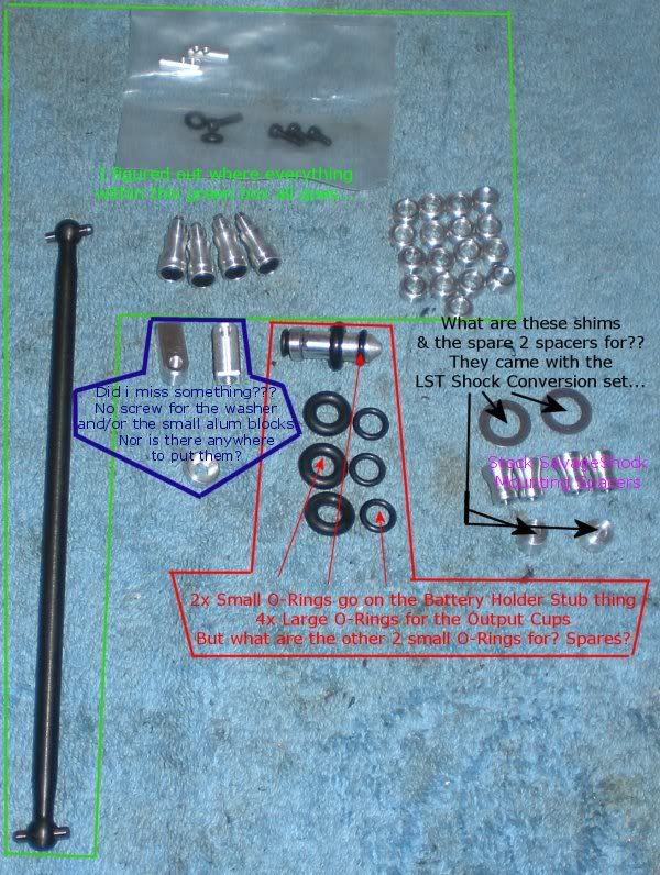

OK... an update =)

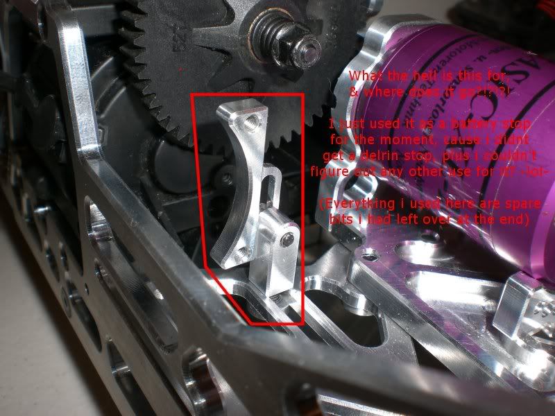

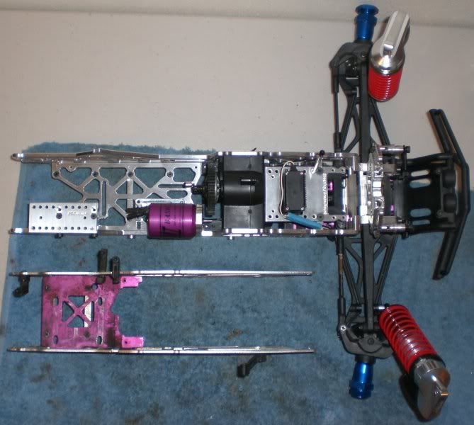

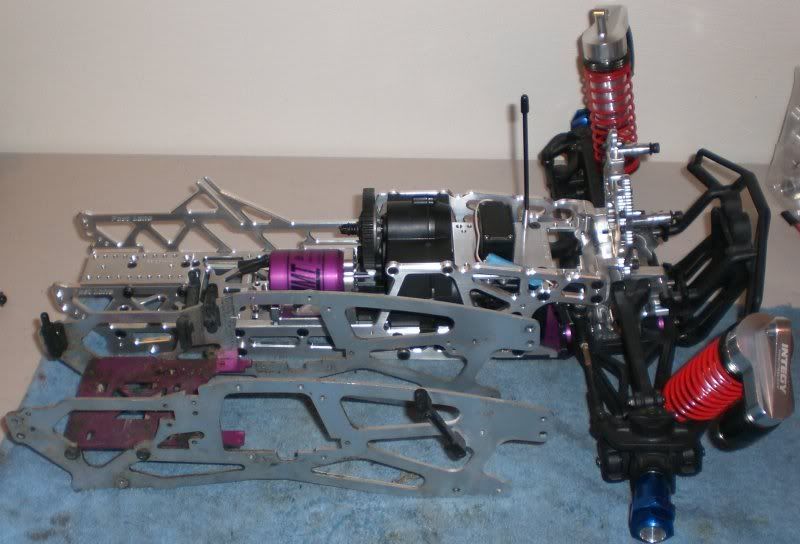

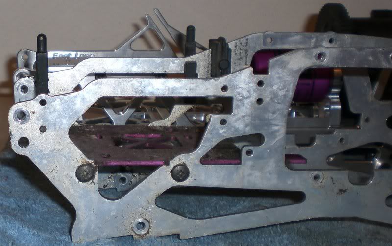

Got most of the front end completed, with a few adjustments and things to change round etc, but need some more help, as it seems i have a fair few left over pieces... i seen another thread with the same problem - only he had way less left over bits than i did -lol-
Anyways - pics explain it all i think... with the first one - i need help with the RED/BLUE & BLACK text/boxes please - OH and the last picture has me STUMPED!!
thanks guys!

Sammus
Sammus's Avatar
Posts: 1,161
Location: All over Australia.
07.27.2008, 02:10 AM

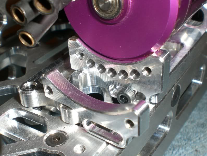

I'm pretty sure your battery stop is a rear motor support. In my revo mount I got two that looked like that. One for regular 36mm can, and another for (what I assume is) 40mm neu can.
danhfvcsd
07.27.2008, 02:31 AM
-lmao- OF COURSE!!! mannn - i been smokin wayyy too much lately -lol- thanks man =) i just needed your post to kick my brain into 1st gear -lol-
It's a spare mount - it replaces the current one for use with larger motors... why didn't i think of that?? -lol- i never noticed the difference in curve on it, and just assumed it had to go somewhere else... i thought rear motor mount support - but then there's nowhere for it to fit -lol-
pics tell the story =) Thanks Sammus!!

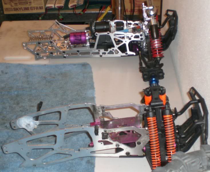

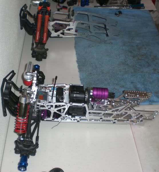

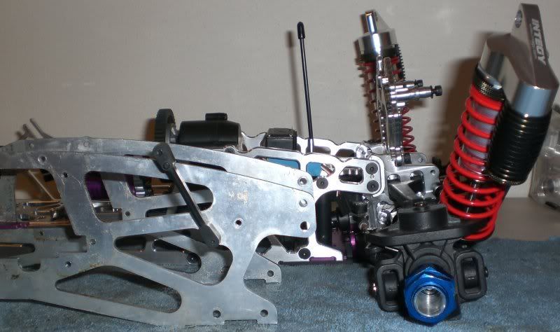

danhfvcsd

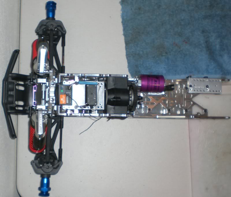

07.27.2008, 07:42 AM
Just some side by side shots with the old chassis...
