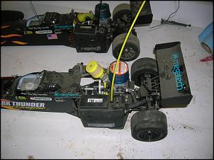

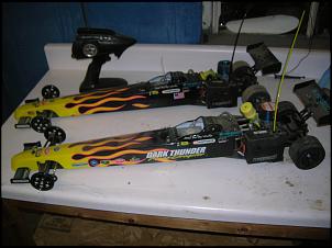

OK guys...need your opinions...
I can get my hands on two Megatech Dark Thunder Nitro Dragsters.
A buddy has access to a warehouse that we can set up a strip.
Now my question, do you think it would be worth converting it to brushless? Has anyone done it before?
It has a two speed tranny that goes into a rear straight axle. The only relief for the drivetrain is the Clutch bell.
I will need to use the mech brake unless I can rig something in the, so called tranny. (Haven't looked at it close yet)
What do ya think???
