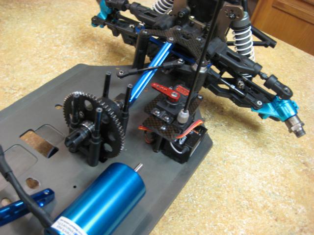

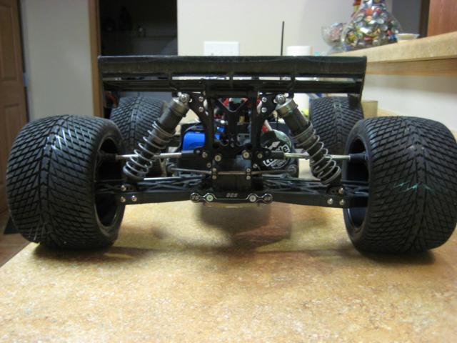

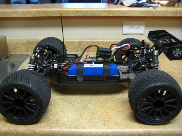

This is my converted Losi truggy i finished about 6 months ago. I'm running Neuenergy and the new Hyperion 4S and 5S G3 35C packs. I usually run 14 or 16 tooth pinion with 50 tooth spur. Thing is crazy fast and handles very well on-road.
The Project I'm working on now is my Mutilator which is quite hopped up-just awaiting RCM Hyper motor mount and batt. tray.
I'm running on-road mostly because there aren't any real tracks up in Fargo, ND. Winters eliminate 6 months out of the year.

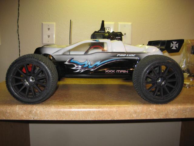

Very nice setup on the 8T. I love the color choice as well as the stance of it. Any bodies?

I do have a 1.0 body that I airbrushed, but I don't use it much because the motor and esc get a lot more airflow with it off. I'll try to post a picture with it on tonight sometime.

Beauty. How do those G3's perform in the 8T? ;) I have a 6s 4200 35C pack and it crazy.
Jesse M
Jesse M's Avatar
Posts: 29
Join Date: Mar 2009
08.15.2009, 01:24 PM
The G3s are nice in the 8T. Probably a bit more power than my Neuenergy 30/60, but the temps on the G3 batt. are about 10-20 degrees cooler on average. 95-110 compared to 115-130 after a hard run
