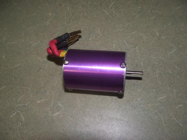

Since Medusa is not honoring any more warranties, I figure I had to fix my motor myself. I was running my XT8 truggy in reverse when I hit something quite hard. This caused the rotor to pop the rear endcap off. The endcap is not crimped or anything, just glued. So, until Mike has his heatsink/clamps available, I figured I'd do what I can to fix it.
First, I found some screws that would be small enough to work. As you can see, length is very important so they don't hit the coils, so I dremeled one down.
Then, I measured about 2.5mm from the end of the motor can (excluding the end cap lid) and drilled two 1/16" holes on each side of the motor just far enough to go through the outer motor can, and then mark the endcap, but not all the way through (to avoid hitting the coils).
I then removed the endcap and finished the holes in the endcap.
Then, I pulled the endcap as far as possible before it would pop off and gooped a bunch of red locktite around the edge. To make sure the red lock-tite would work, I called Locktite and spoke to a tech. After explaining my situation and application, they suggested the red for its heat properties, and recommended the gel to avoid it dripping where it shouldn't.
After snapping the endcap in place, wiping off the excess locktite, and screwing the trimmed screws in place.
I probably should have used three screws, but couldn't find one small enough anywhere. I just happened to have the two I used in my screws bin.
Anyway, after letting this cure overnight and most of today, I made an experimental solid tap on the pinion side of the rotor and it seems to be solid. A little driving around worked fine too. Time will tell if this will work long-term (or until CC releases their 1800kv motor).

Brilliant Mod Brian!
I've been thinking of attempting this myself. Maybe using more screws.
The endbell is a really snug fit. I wonder if using 4 - 6 screws and just loctiting the screws would be enough? Maybe with the Blue or possibly the green?
I would love to make my Medusa's easily rebuildable.

Wow, nice. I don't think I'm accurate enough to drill such small holes so precisely at the end of the motor though.
Do you think using some CA glue would hold the endbell in?
Oh, and that looks like a V2.
08.05.2009, 10:00 PM
Thanks guys!
CA glue probably would not stand up to the shock and heat on a motor (especially heat). Not to mention CA works by chemically bonding with plastic/rubber, which probably won't work as well with metal, if at all. I was thinking about JBWeld too, but noticed that it tends to get softer with heat. I don't plan to overheat my motor, but better safe than sorry. From what I understand, Locktite works by turning into a plasticy substance and expands, while bonding somewhat to the metal, so I figured this would work better. And the screws are just to make sure. I may add a couple more screws if I can find some that are the right size.
It doesn't take much accuracy to drill the holes; just go slow and apply "back resistance" so you don't break through and hit the coils. In my case, I had nothing to lose since the motor was pretty much shot as it was.

I figured it was just a matter of time before someone did something like this. It's pretty much a Neu now! I would take it one step farther and get a tap and thread the end cap so the screws go into it, just like a neu, and only use a dab of loktite on the screws instead of the whole end so I could get it apart in the future.
Maybe I should have taken a better picture of the endcap, but there's really not much thickness to tap. It's maybe 1.5mm thick, if that.

I had to do the same thing with my Faegiao motor because the rear kept popping off and a bad wreck into a storm drain took the front endbell out. I used 4-40 X 3/16 button head screws. And also used the Green Locktite sleeve retaining compound. (it's what they use when they have to replace a sleeve in a lot of LS and Hemi and other engines). I had some laying around and Snelliemin needed to bond a rotor back onto the shaft of one of his motors.
