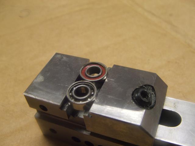

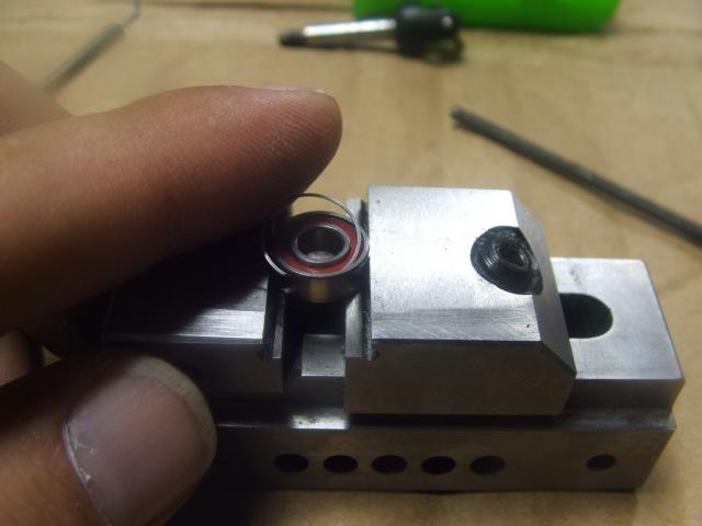

First I start out with the bearings as is. I use the vice to hold the bearing and the pick to remove the retaining ring that holds the shield in place. Do this by slipping the edge of the pick in the groove and hooking the retaining ring and pulling it towards the inner race, then slide it up and pull the ring out. Be careful as it can fly off like an E clip and it'll be real hard to find.
The retaining ring looks like a ring that has been cut diagonally. You want to slide the pick under the side that is sharp side close to the inner race.
Once you have the retaining ring off one side do the other side and other bearings. Remove the shields as well.
