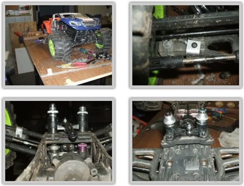

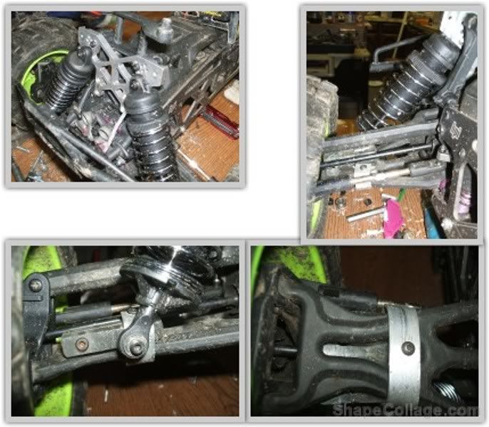

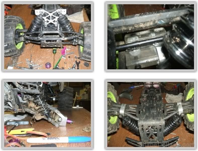

I had to make some bracket dew hickies for the bottom of the shock to move away from the tire. First one went fairly smooth and it kind of looked like I read the game plan. Then the second one I screwed the pooch and did it backwards and upside down it seemed like. Kind of like you hear the high heels of your boss approaching and you know he's looking over your shoulder....
The bracket look ghetto but heck I run through the trailer park when I am out playing anyways. Oh yea, that's the look I was shooting for too. I do like the way they look and how the XL handles now. I'll take a couple pics of the junk drawer that's now hanging on the arms of the Savage. One way to look at is I have more room in that drawer now. You should see what ends up on my x-mass trees. I will not be able to hear any laughter from you fellows, but I will get the warm ringing ears and that uneasy feeling like when the Gieco eyes are watching me again. I wish he would just say something already! Without pictures this post is just words after all.
When I first started the project I was going to make a support and brace setup from some 3/8 lexan. I got a half ass template of one made when a thought came to me and it paid off. I took some old aluminum e-maxx shock towers I bought from Full Force RC. They had to have a hole combination that would allow me to connect them up to the stocker towers. I know the doubt was there, I've dealt with it since grade school. Puzzles just aren't my thing alright. Before you hear it from somebody else. I still haven't solved my rubics cube. There, it out and I feel better about it. It's on the bucket list right before the prayer for forgiveness, plenty of time left. I did find the right hole combinations on these towers. I might just dust off my old square nemesis. Nah, plenty of time for that later...
Making some spacers for the top holes was another scavenger hunt and a McGuiver test I didn't even study for. A 5mm flanged axle nut fits into the top hole backwards real nice and one on the other side is almost a perfect fit but a little slop between the two. A little slop is something that most men just have to live with. Not on our RCs though, especially if you have a choice between a tight fit or some slop gong on. Tight fit is Tight in my book, if that's still a hip word anymore. I continued my desperate hunt for that perfect fit, the one that feels right. Some never find it and spend their whole life trying to get back into the womb. I say live for today and get the hell out of the town you grew up in for a little while. Kiss someone besides you cousin. Just cuz she is good enough for the rest of the men in your family no reason you have to settle for it. Back on track again. I found a combination of items that when put together they were the perfect fit to the shocks top mounting hole.
