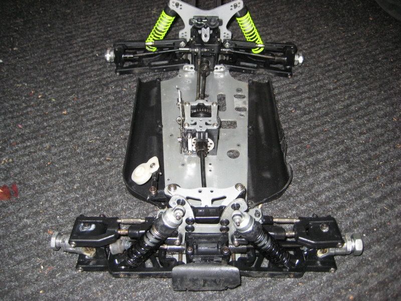

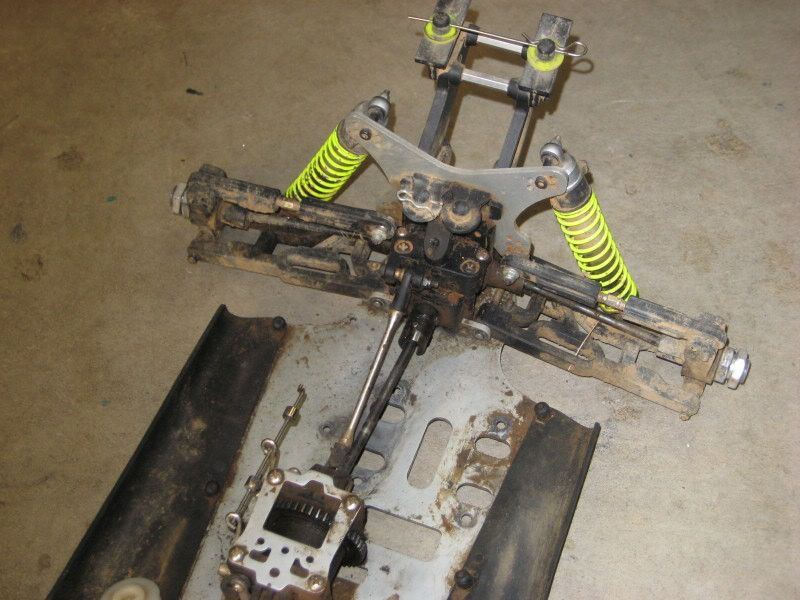

cobra198
12.19.2008, 10:25 PM
Thought Id post a few pics of the buggy before the conversion. Got her all nice and stripped down and cleaned today!
The Nitro Setup (A bit neglected when I took the pics - I know):
Photobucket
Photobucket
Stripped down:
Photobucket
Photobucket
And nice and clean, all read for the new parts!
Photobucket
Photobucket
Not too bad for a relatively quick clean job. Still just waiting on word from RC-Monster Mike about the mount. Once I get the motor, ill be able to start mocking up the configuration.
