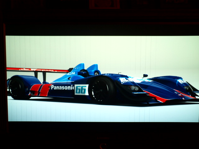

My 1/5 scale needs a cool body and was wondering if there is a thread or a different forum on how to make your own body ?
All I know is I need to sculpt a mold and then vacuum form it
Want a body like a GTP, Ferrari Enzo, LOLA . Something Low and race'ee
