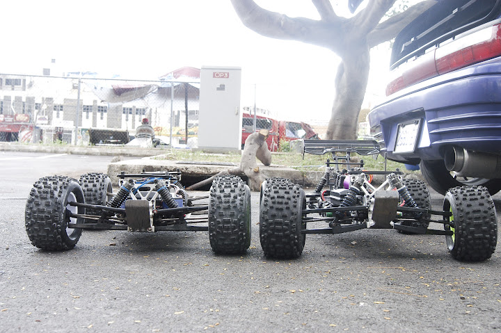

Here's an example of two truck with '1/8' shocks:
The truck on the left is running 4 Ofna 1/8 front shocks and the truck on the right is running 4 UE Supershocks (basically Ofna 1/8 rears)

Hmmmm... I'm thinking 1/8 rears might be a little difficult to setup with the stock towers... but the FLM towers will facilitate them well... Maybe you could try a funky combo -
'1/8 fronts to the front and 1/8 rears to the rear' (typically of a 1/8 buggy)... or just stick with fronts all around...
