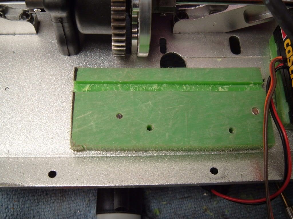

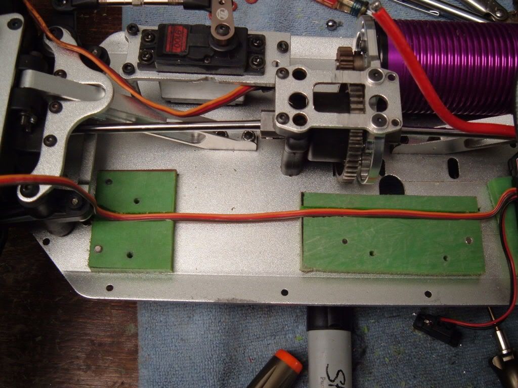

I modded the stock radio tray to hold a single servo. Pretty easy to do, I just cut the throttle servo mount portion off, and drilled a hole in it to attach to the center post that hold the tray on. So it now has 2 front posts, and the center post as the rear support. Used a jato turnbuckle with revo pushrod ends to make a link to the saver. Still need to do the steering mod and add bearings.
Power system is a hacker c50 11xl (1476kv) with a MMM on 6s lipo. Stole the battery tray out of the lst, and made some risers out of delrin to clear the raised edge of the chassis. Made an esc mount out of the delrin. All of the delrin mounts are held in with screws thru stock holes on the chassis. I have not drilled one hole in the chassis. I also took the router to the delrin risers and made channels in them to route the MMM signal wire to the rec. Did the same to the esc mount so that I could put a ziptie on to hold the esc down. First time I have seem this, keeps the wire out of the way, and safe too.

That is a rather clever idea with the routing, gotta like fewer wires dangling allover the place Shame the servo lead isnt a bit longer- you could route it along and under the battery tray & have it emerging in the same spot as the esc's rx lead to plug into the rx.
04.15.2009, 12:33 PM
That lead is a bit short. I will just ziptie it to the front chassis brace, the rec will go directly behind the front shock tower.

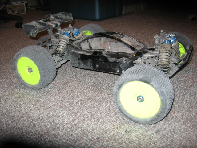

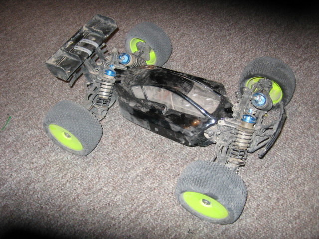

Muggy?? - 04.16.2009, 09:35 AM
Here's my one of a kind Muggy with 8ight body and custom chassis brace. Fresh from battle, it will do a wing stand at almost any speed! Not as agile as my 8ight-T but what an awesome machine.
ID:	6836   Click image for larger version
