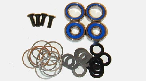

Thanks, but the link is not working with me. BTW, I bought the 8 spider gear set which means I will need a setup kit for these diffs. Mike sent me this setup kit, only. Is it this the one I'm supposed to use with the gear set:

Do I need two of this or only one?!!

I had a 6 spyder set and only used one. You need adobe reader for the link.

The bearing holes have a very tight tolerance. The UE VBS is about the same, to be honest. Most every intricate design will have slight areas where you may have to trim a touch (UE VBS is tight in the suspension arm area, for instance). I wouldn't dremel th bearing holes, though. The bearings are snug, but they will go in. Also, one diff setup kit is usually plenty for a pair of diffs. You may not even need those, but better safe than sorry.
