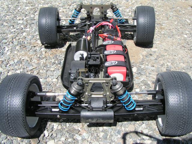

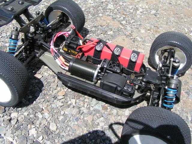

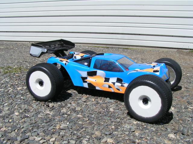

I don't think I have seen one of these on here yet, so I thought I would post a few picks of mine. I used the Losi battery tray, and a home made motor mount. Power is 6s Neu 4100mah on a 1515/2.5D through a MMM. I know most guys here racing with a 2.5D are only using 5s, but I am only geared for about 38mph, and my truggy got TQ on it's first outing. I let another (much better) e-truggy driver try it out, and he wanted to know all my settings and all about my truggy. Sadly, the stock plastic servo arm let me down at the start of the main (notice new aluminum one in pic), so no win there.
