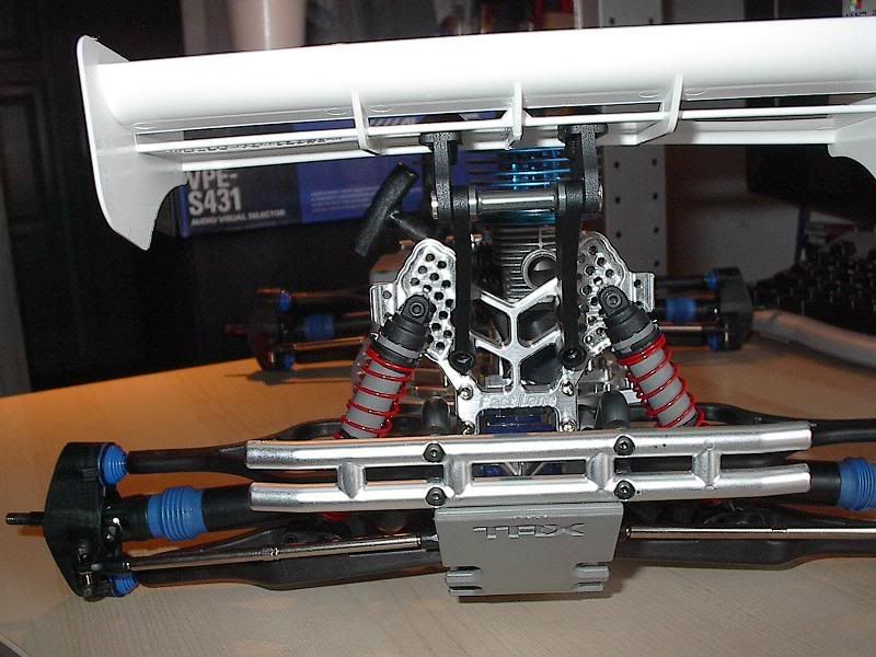

It's a little tricky at first, but it does work very well once you get past finding the right screws. I also had to "open up"/make larger/drill out two of the holes on the FLM shock tower. The mount doesn't come with screws. I used two of the screws that FLM sends for mounting shocks (the ones for the stand-offs) and then two long 4-40 screws.
Here's a pic:

Line up the bottom screws with the top set of shock tower to chassis screws...then line up the top set of wing mount holes with the holes you are now using...it fits. Essentially you will be dropping it 1/2 inch.

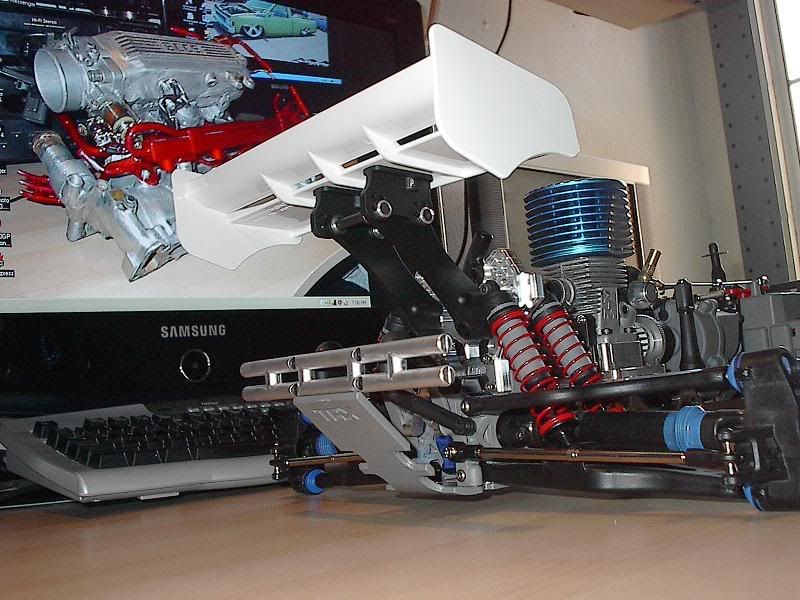

Here is how I mounted mine:
ID:	2925   Click image for larger version
ID:	2926   Click image for larger version
