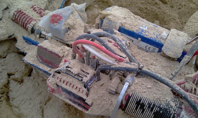

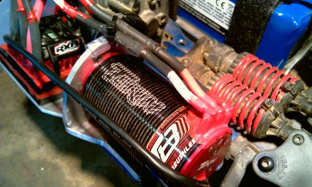

I closed this and also the Gap at the RX8's Heatsink with PlastiDip.
When driving in the dirt i think this is essential because the Gap in the Motor leads directly to the Rotor.
Also Sand in the ESC could damage the protective lacquer on the board I think...
I closed everything with PlastiDip, so there's no way for the Dirt to get in.
