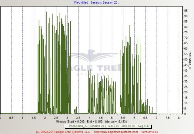

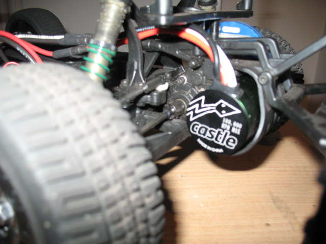

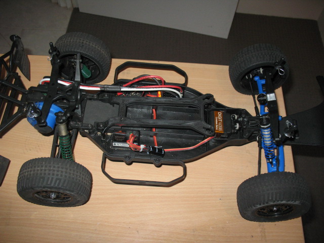

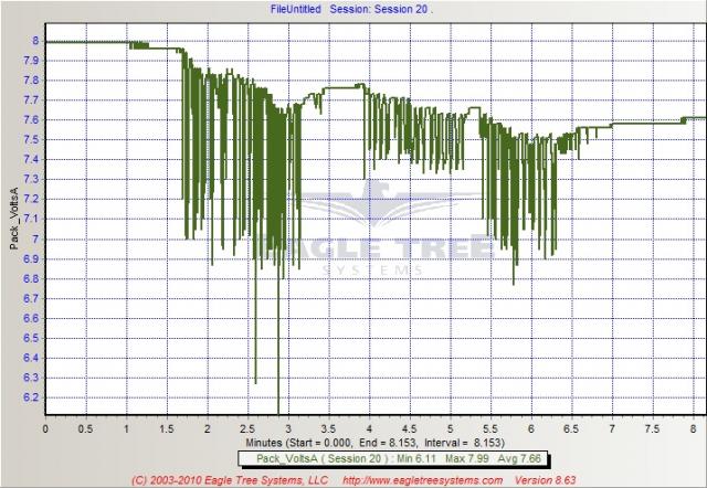

anyway, had the eagle tree on it (only a short test out the front for now)
At this point, I think it was great value no doubt, the motor alone is worthy of the price tag IMO compared to what a VXL motor goes for (just shattered a rotor in mine yesterday on 2s Lipo in training mode!) The ESC feels cheap, the board moves around in the case, the BEC struggles and cogging is a significant issue at low speed. Hopefully playing with some settings I can minimize it but still....
Here are the pics / graphs (3 distinct runs, 100% EPA, 65% EPA and 80% EPA)
