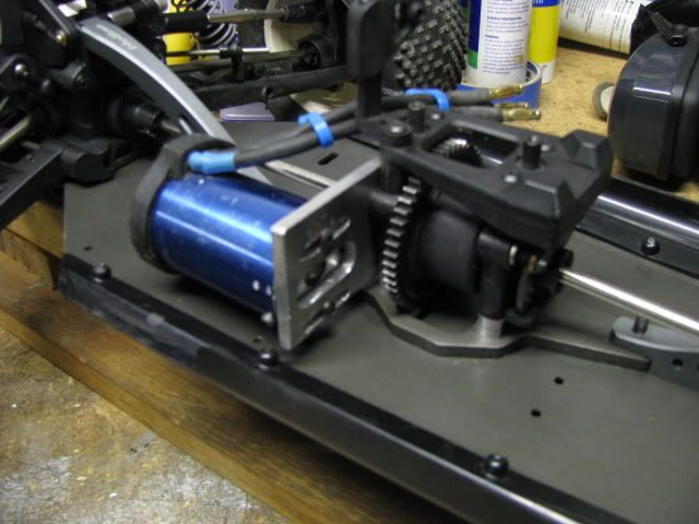

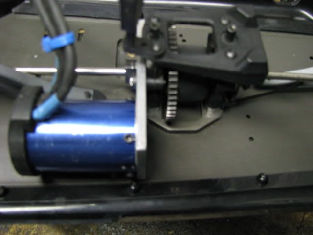

I brought a Hyper ST Pro roller last week( Minus Centre Cvds and Spiderdiff) for $250AUD which i'm very happy with.

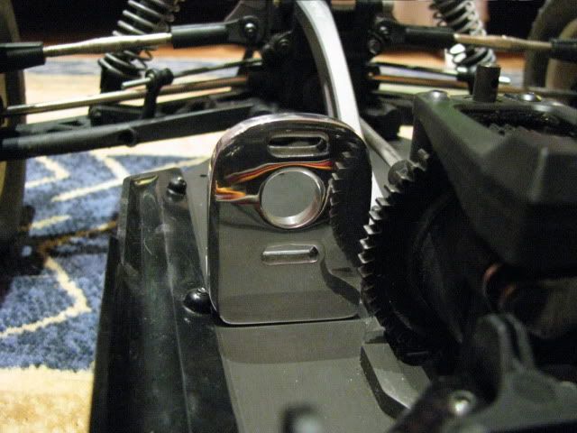

So today i go on to making my own motor mount(I don't want to spend money on the RCM mount if i can) and it took me a few hours to perfect it and i'm quite happy with the final result apart from it has a slight amount of flex, but does that matter?
I plan on running a 70mm 2300 medusa with a MMM on 4s when i get the funds.
Pics of todays progress:
Yes that motor has no shaft as i dropped it last night and it broke off which i'm not too happy about!
The mount still needs sanding and polishing but apart from that it's pretty much done.
brushlessboy16
brushlessboy16's Avatar
07.11.2009, 09:56 AM
NIce mount, and the motor shaft is definately an "oops" moment, what Esc and batteries do you plan on running?
07.11.2009, 10:10 AM
Flex in motor mount matters - Ask Ben (b16)...
You will just chew up your spur and pinion / Worst case you will break your motor shaft...

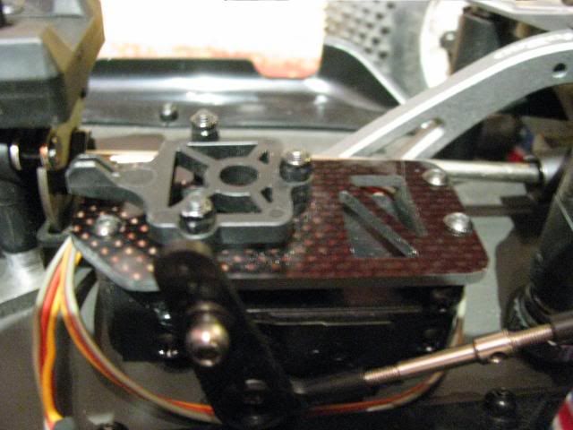

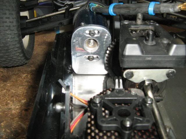

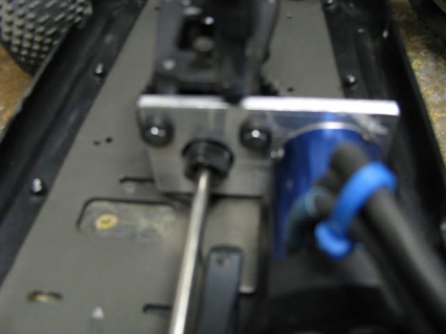

07.12.2009, 03:49 AM

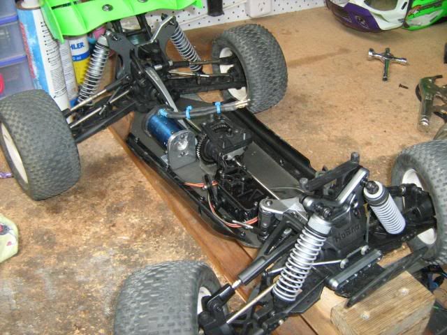

Well today i made a new mount out of 50mm aluminium angle and im impressed with it. Best thing is it flexes 0%
Pic's to follow tomorrow.

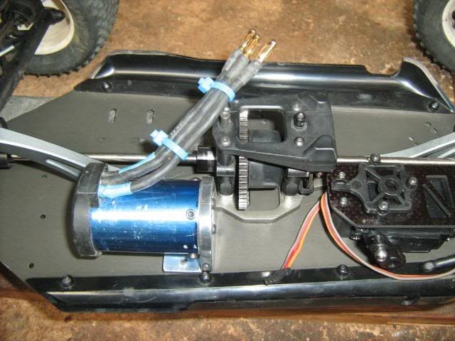

07.19.2009, 11:37 PM
All it needs now is a MMM Combo, 4s zippy and a Nice radio.
Pics:
jsr
Posts: 212
07.20.2009, 02:00 AM
The mount seems somewhat far from the spur. Are you sure you won't have any problems with the pinion reaching the spur? Even though some pinion gears are pretty long, I prefer to not have the pinion overhang (extend further than) the end of the motor shaft.
Since you have machining capability, why not machine a mount that replaces the rear center diff bulkhead like RCM mounts?
Mystro
Posts: 73
Join Date: Jun 2009
07.20.2009, 02:22 AM
Hmm, i don't think so. I put a pinion i had laying around which is very close to 1 mod where the motor shaft should be and it reaches easily.
I see that Tekno stock a range of "long" pinions which are double hardened. They seem like the way to go.
It just takes so long to measure, drill, tap, file, cut, sand and polish to make another mount. If this one doesn't work the next step is the RCM mount.
