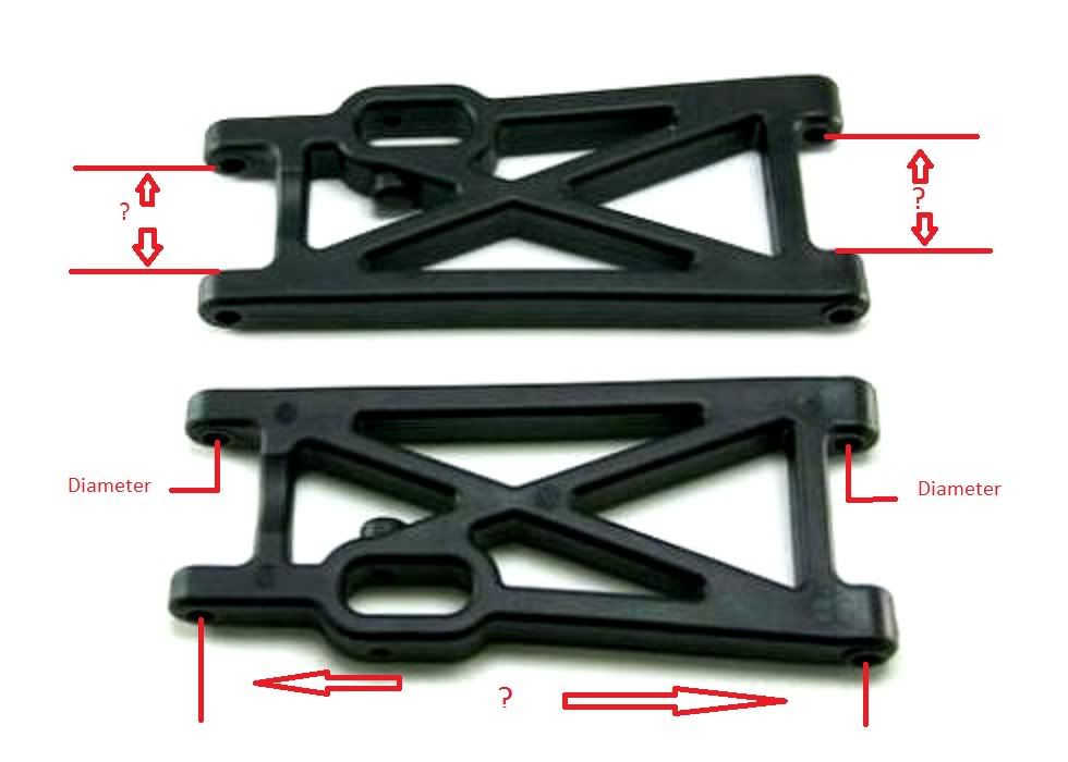

Hey guys, I need your help!!!
I need everyone with a truggy to measure the rear arms for me.
I need to know the distance between the inner and outer hingepin holes.
It would also be nice to know the inner and outer hingepin hole diameters too.
And if you are feeling frisky (stop eating cat food) these measurements would be nice too (see pic):
Working on a suitable replacement for a savage lower arm. But I need more info.
Thanks guys!

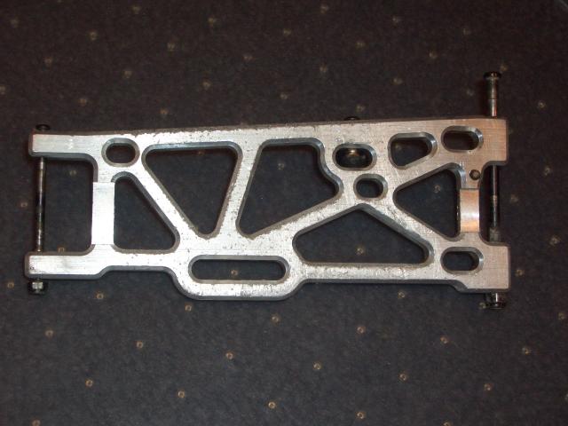

Luckily I have a jammin X1 I'm trying to unload.
Inner hingepin = 4mm diameter, 25.3mm inner, 58mm outer
Outer hingepin = 3mm diameter, 28.7mm inner, 45.2mm outer
145mm length
