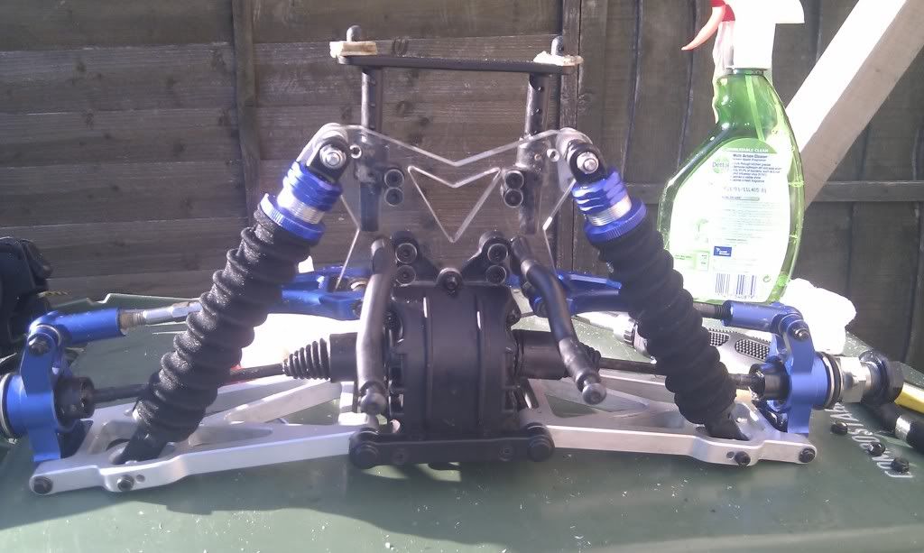

As some of you know... im blinging out my savage with anodised parts and custom bits...
I wanted to show off my internals from below as my ESC plates etc will block my view of my centre diff etc from above...
So...
I met a guy who makes BulletProof Windows from high grade polycarb meaning they are virtuarly indestructible... Anything 6mm and over is considered Bullet Proof
This is my 2mm skid plate.
He can make them to any dimensions required
He even makes shock towers from 8mm material as well as other bits and pieces
He will make what ever you want as long as you send a template to work from and he will then send your template and finished item back to you *:P
They are even experiementing with thicker material and chassis....
Looks promising.

It look like he does nice work. Polycarb works great for making parts. I've never had any problems using threading a hole in it. I just drilled a hole slightly smaller then the screw and then work the screw in and out of it until it reached the full depth. You let the screw do the threading and try not to get it too hot other wise the threading will not be as good. Hold a screw tighter then the stock plastic parts if done that way. I have used the insert on a couple of occasions when the whole was offset or drilled to large.

yes but although bulletproof there can still be a little flex in the material. And the strain most likely put on the centre diff/motor mount, would most definitely throw a mesh off...
Obviously wouldnt know till you try it out though.
I like the idea of Bullet Proof Bulk heads. See through bulk heads would be very tough as well as offer a way of viewing the gears as the work!!! But i do not think they would be possible without some form of milling machine.

Those parts look great. Polycarbonate is great for making flat pieces. Bulkheads would be difficult since polycarbonate does not take kindly to being threaded.
