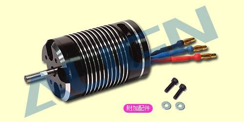

I think the motor is an Align 600L or 600XL heli motor. Are you sure it's 2350kv? All the listings I see for the Align are 1650kv.

The motor in the pics looks like a Align, but he said the motor in the video is different than the one in the pics. Cool RC man. Its a little different, and we like that. Whatever it takes to have fun right?

@simplechamp: yes, you are absolutely right, on the pictures, that is an Align 1650 KV motor, but since it was overheating like crazy, I swapped it. Now I'm thinking on a 3674 size motor, somwhere in the 200-3000 KV rating. What do you guys think?

If it's a 2 pole 3660 motor like a feigao, it probably won't survive depending on it's Kv. Those type of motors generally only stay cool if kept under 35k rpm, 2350kv on 6s is probably going to heat up pretty quick. A heatsink with fan and keeping the speed under 45mph will help, but I'd keep a close eye on temps if you're going to try it. And if you're new motor is going to be a 3674 2 pole run on 6s I'd get a Kv of 1700 or less to keep the Rpms and temps down. You can always slap a bigger pinion on it if everything is within safe limits. http://scriptasylum.com/rc_speed/top_speed.html is the link to the speed calculator, you can play with different Kv, voltage, and gearing to figure out speed and Rpms. Check out the rest of the site for other help deciding on motor size and Kv as well.

Overdriven, thank you for the useful advices. This motor would turn above 39K, and that is a lot more, than you suggested for safe zone(in this setup, the temperature goes up to 50-55° celsius, so I guess I drop the 6s LiPo). I've made another conversion-actually two more- but both of them are in experimental phase, I have to find out the weakness in them. One of it is a savage x, the other is a Serpent 720 '08. Both of them are in working order, but I want to throw on them everything to smooth out the rough edges :)
