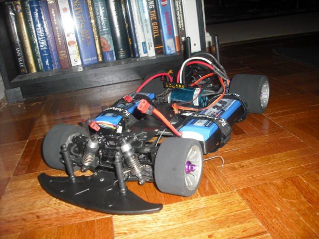

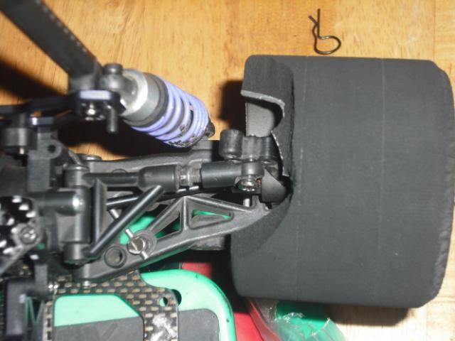

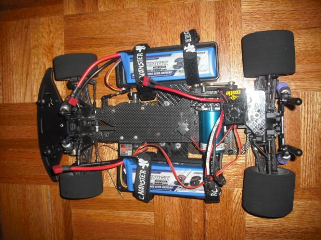

I love you choice in models. I converted one a couple of years ago and is an on going project...it is now a 6s monster. Blew a chunk of foam and wheel off during a bench test.
