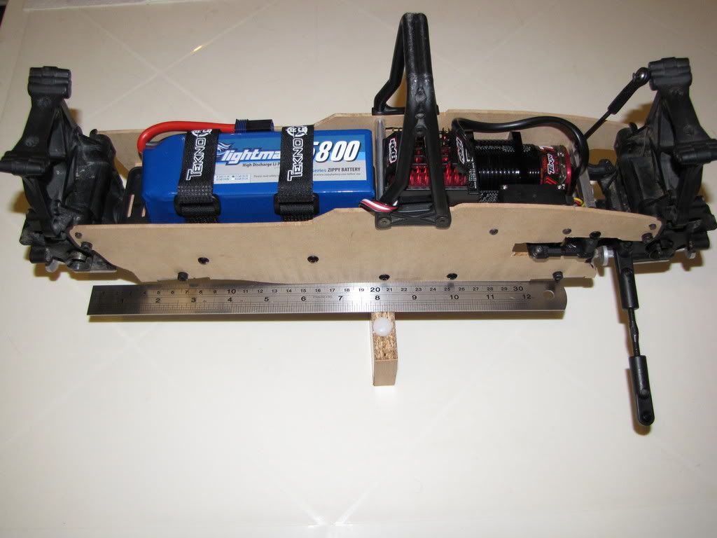

The main focus of this project is to build a simplified Flux basher by removing legacy parts (gearbox, radiobox) and to use a single large battery with the TVPs. I was happy with the length of the Flux, the XL chassis is just a necessity for having a battery within the TVPs. Initially i looked at conversion kits but all of the XL ones had limitations that i did not want. Like small battery compartments and they all still used the gearbox.
So i started investigating if it would be possible to have a decent sized battery compartment within a custom XL TVP layout. Initially i was inspired by Janezki's Savage XL-E build and various center diff builds. Whatever i looked at it either had a small battery compartment, batteries still in boxes, batteries or motor mounted high.

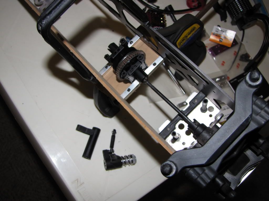

After testing layouts with a cardboard prototype i discovered the limiting factor was the steering assembly. It limited a front mounted motor from being moved forward and\or forced it to be mounted rather high. So the real crux of this build is that i have reversed the servo saver arm to move the steering linkage away from the center of the chassis. I tried various other solutions but this was the only one that looked like it might work.

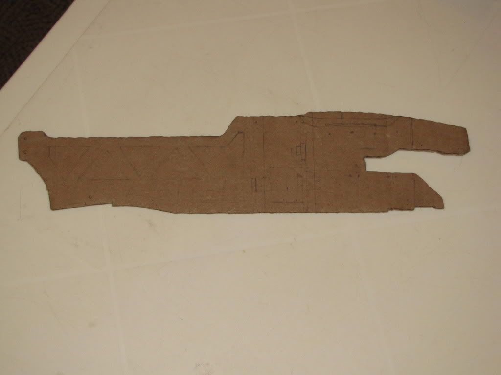

Initial cardboard protoype
