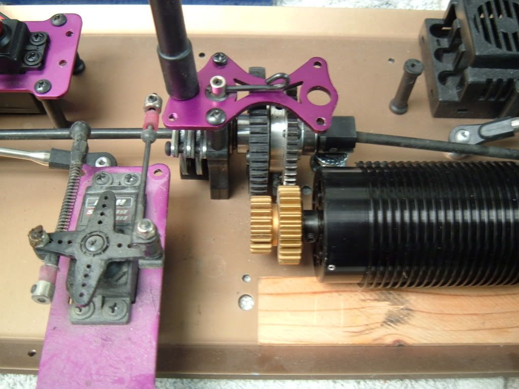

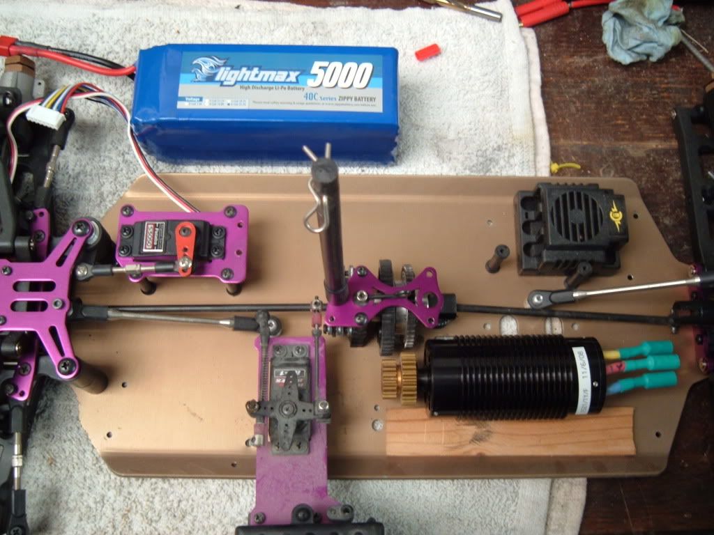

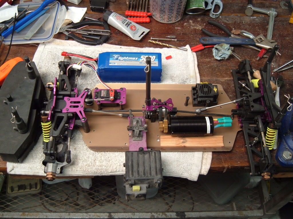

Ok, did a mockup. Will need to move the steering servo over to the motor side, will likely make a servo plate that will hold the steering servo and the brake servo. Esc will go next to the motor at the back, as in the pic.
The motor is not the correct one but it gives some idea of placement.
Battery tray will go where the steering servo currently is. Will overhang the chassis slightly in the middle due to the spur location. If I had a slightly shorter battery it would fit infront of the spur and behind the steering cranks but oh well...

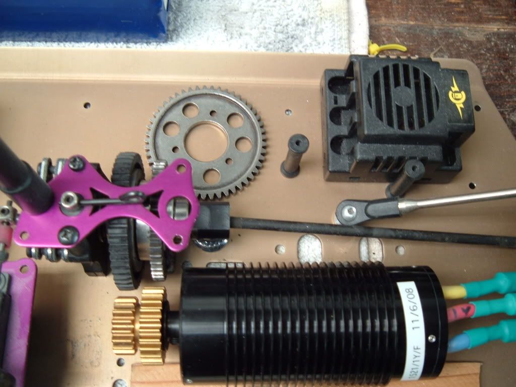

Current 2 speed setup is 42/49, mocked up with a plastic 49t gear, the other gear shown in the photo is a mgt steel 49t spur that I need to have modded to fit the 2 speed assy. I was going to run 18/25 pinions, but the 42/25 gearing would be over 110mph with the 2200 motor. Will stick to 16/20 gearing and run the stock 46t 1st gear spur and have top speed around 90mph.
If I was to use the 1521 1y I would run the 49t spur for 1st and the 18/25 pinions. If the 2200 cannot handle the load I will have to switch it up. Will require a much more elaborate motor mount...
So I will stick with the 2200 for now. People say they are great motors, and I did have good success with one in an lst on 5s... Seeing this thing shift into 2nd gear around 55mph will be interesting. Will need some serious brakes, thinking a high torque servo for the brakes, and another for steering. Luckily I have a few jr 9100t servos laying around!

Just curious. What motor is that in the pic? Think I could make out 1521?
And also, where'd you get that 2 speed pinion adapter? I really need to get some of those.
12.09.2010, 03:11 PM
Motor is a 1521 1y finned. 1600kv and it has enough power to move my 12lb lst around geared for 45mph or so.
The 2 speed adapter is from the rcm store. Uses lst pinion gears, or (preferably) rcm pinion gears. The rcm gears are hardened and superior to the losi ones. Great products, tailor made for conversions like this!!! Thanks Mike! In your face Tower Hobbies!!!
Need to order some from mike, just want to make sure that the sizes I need will fit with the flux motor installed and not touching the rear center bulkhead.

Looking good... Might I recommend relocating the steering servo to the left side so that the battery can go in the front right to offset the motor?
