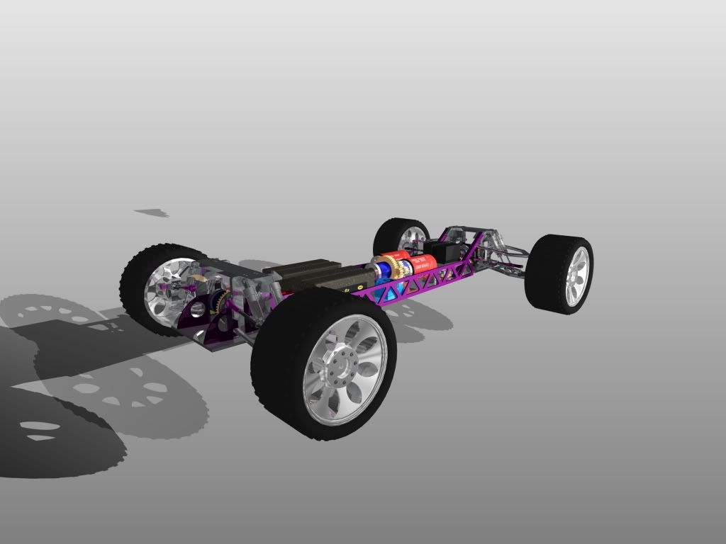

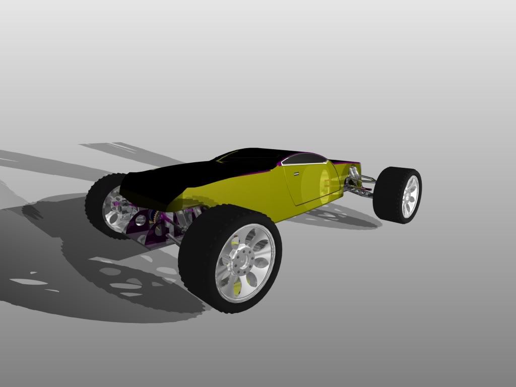

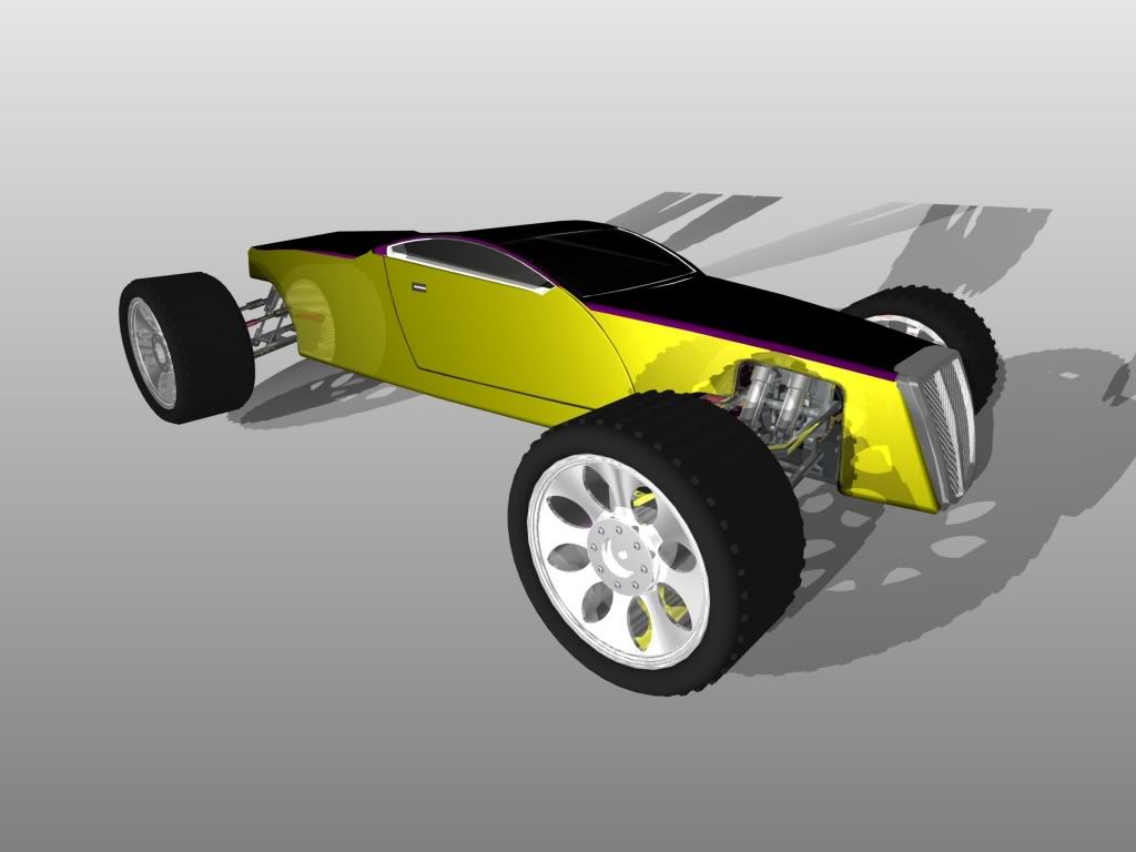

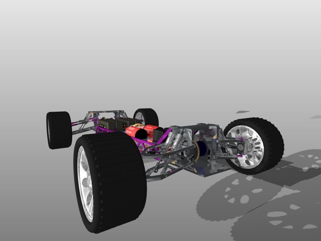

This is my first post here and I want to show some virtual images of a project I'm making, is still in the design phase but is basically ready and I can start joining some stuff that I'll need.

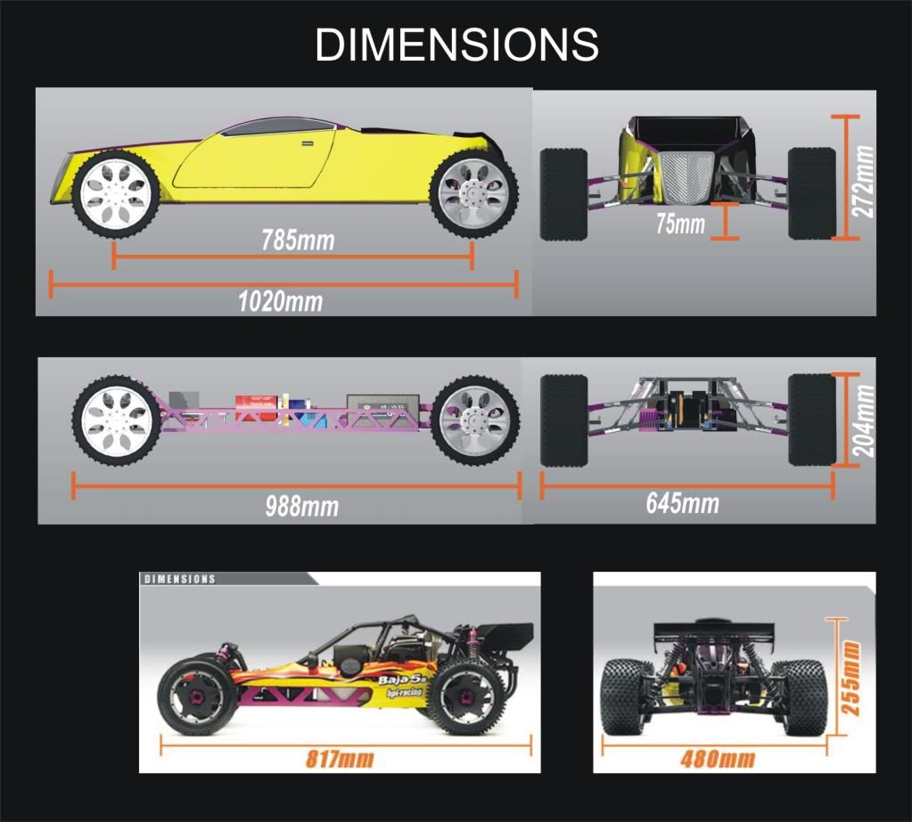

I also did a comparison test between the dimensions of my project and an Hpi baja 5b in order to have a better sense of the actual size!
hope you enjoy!
Spec´s
Dimensions
Lenght:1010mm (40 in)
Height: 272mm (10.5 in)
Width: Front 645mm / Rear 640mm (25 in)
Wheelbase: 785mm(31 in)
Ride height: 75mm(3 in)
Weight: 13.5kg (29.7lbs)
Motor and esc spec
twin brushless motor leopard 5692 1000kv
4x lipo 6s 5200mAh total of 20800mAh in paralell
Esc 150A Xerun
transmission and Steering
4-wheel drive
3 differentials
twin servo hitec 805bb 6.0v(24.70 kg-cm)
tyres Ø 195mm, width 110 mm, rims 110mm

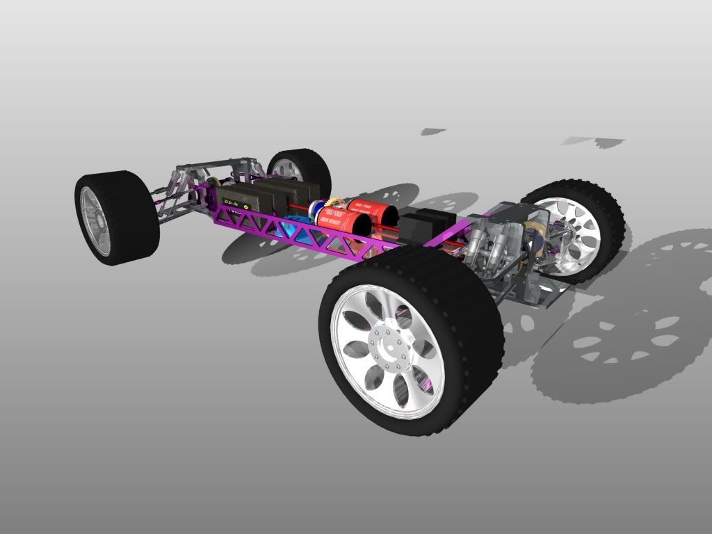

Here is a picture with the two options which can be used to reduce weight or increase autonomy.!
