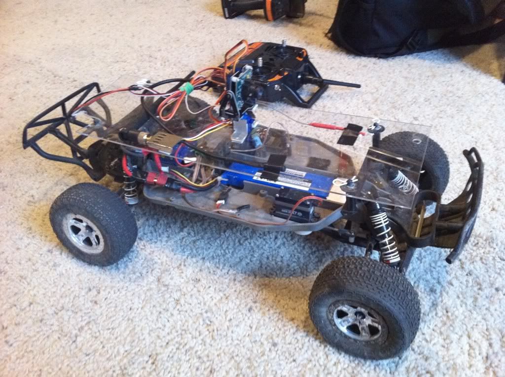

A while back I played with a FPV setup.
Camera on a pan/tilt mount, running 4 channels so I can control camera and truck on a airplane radio.
Worked ok....
The video receiver is on a LONG cable, so it was outside stuck in a tree. I was inside, watching the feed through the TV in the living room, holding the radio in my hand....
That meant the radio signal had to go through the walls of the house to get to the truck. That just killed my range, I could only venture about 150 feet from the house.
