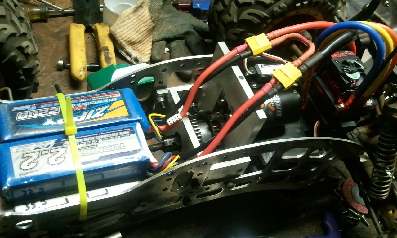

As with every nitro it runs good when I get it, and the more I "tune" the more of a PITA it is. So I finally decided to convert it. Fired up the old solidworks and scanned the chassis plates in. It took a couple evenings to design the mounts and overall I'm very happy. I kept the original differential and driveshafts to keep the cost down.

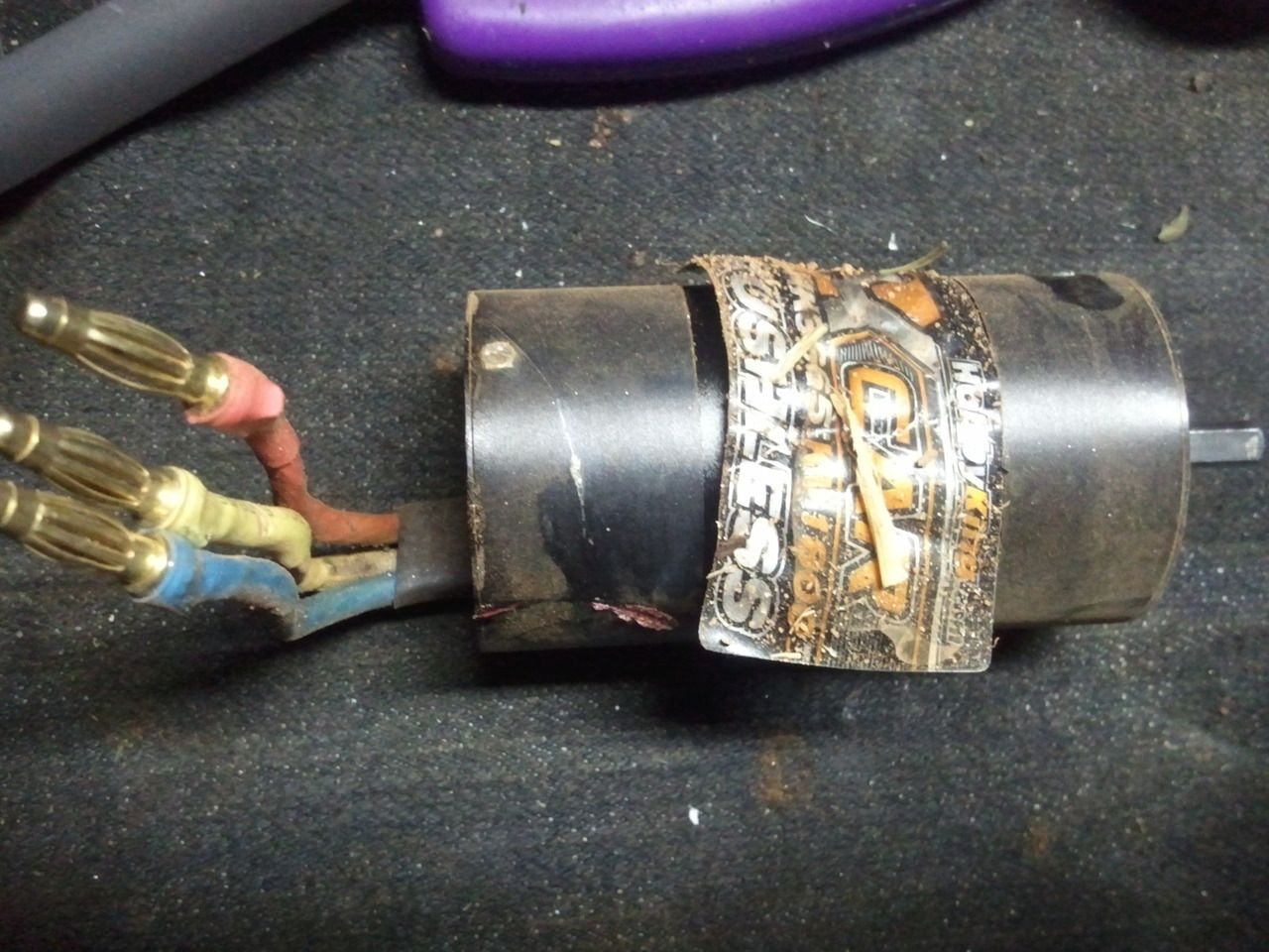

I ran it with a $40 hobbyking motor until my I could get a better motor.

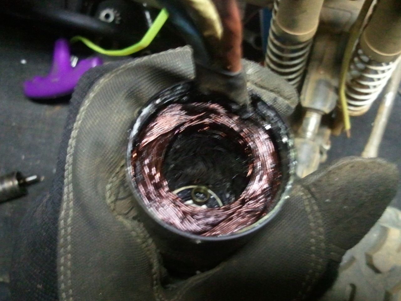

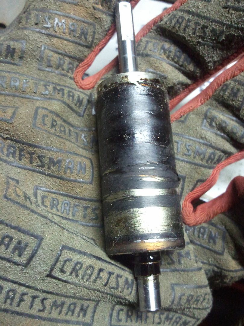

Well the motor didn't last long. Maybe 10 minutes of light to medium driving. The motor was over 100c and the solder at the connectors melted.
The core
Yes it's still very hot
