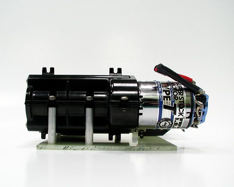

here's a pic of the stock tranny location in "Draggular" version one.

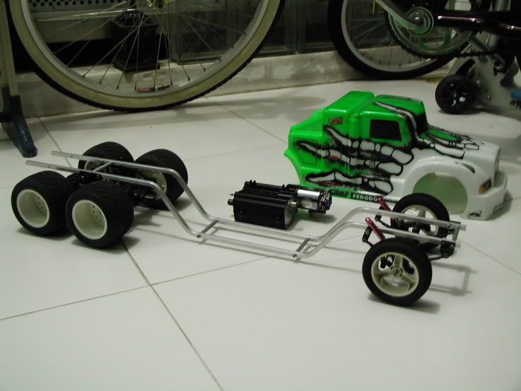

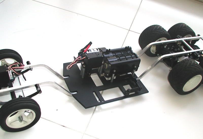

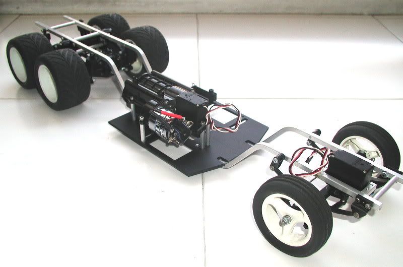

"Draggular II" is a more indepth attempt at a racing hauler....with Z'd chassis frame rails, lowered and "laid over on its side" tranny, lowered batt mounting position.
and yes....my driving has not improved since then...:036:
here are some build up pics of Draggular II...
laid down tranny to lower CG further...
after a little paint on the G10 chassis plate and its starting to look "factory" :005:

Very cool. How is the stock driveline? Cause you know you need a brushless in there...

Originally Posted by Sneeck
Omg that is the coolest thing ever. My next project perhap's.
thanks buddy.....yes go for it! these 3 speeders are great for custom work....
as a matter of fact i do have a BL in there now...nothing serious, just my humble SS5800....but i tried half throttle in 2nd the other day just to see if the shift servo was trimmed properly... and the two rear wheels balloned till they almost made contact with each other!!!:013: not good if that happens....
