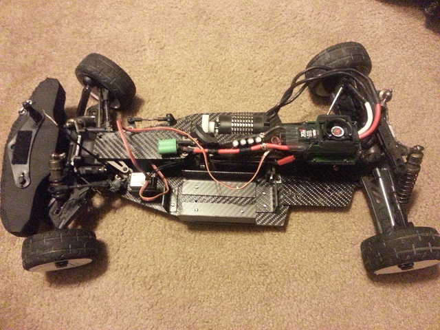

I finally got a chance to tear down the wreckage and it wasn’t nearly as bad as it looked. *The chassis is completely intact. *The 4.4mm CF chassis Held up beautifully against the curb and was wholly undamaged. *The plastic and aluminum parts though, I cannot say the say. *The damage tallied to be:
The front and rear lower arm holder plates
The front upper arms
The front and rear shock posts
The 3mm screws were stripped out of the front and rear gear boxes
I plan on fixing the stripped screws buy re-tapping with 4mm screw, as well as cutting out my own replacement shock mounts made from the same chassis material.

I thought it would have been worst. Only broke a few things and the best part, the front and rear shocks have already be re-built, better than ever. 4mm carbon fiber, this is not breaking.

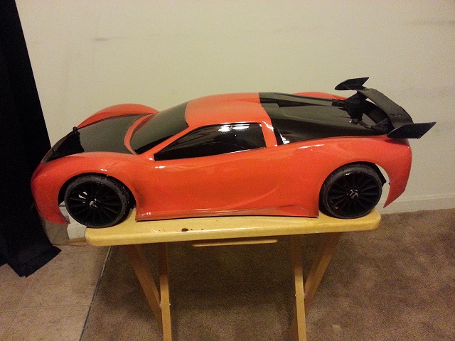

After about a month and a half of cutting, trimming, painting, testing and glassing, the monster is back and better than ever. Changed the gearing to go faster and the color to see better at longer distances, the Beast is ready.
