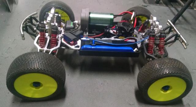

I am nearly complete with the design phase of a new EMaxx chassis(1 of possibly 2). The goal of this particular chassis project is to upgrade the looks, durability, handling, and versatility, while retaining the stock size and mostly stock components(including chassis braces). This strategy was chosen for this particular chassis to keep costs relatively low, while providing a high value. It will look and perform like a high dollar upgrade without breaking the bank.
I won't delve too deep into the specifics, as I hope to get a prototype or to cut this week. I am, however, undecided on the battery trays at the moment and any feedback would be valued. Aside from positioning the trays slightly above the bottom of the stock chassis brace to maintain ground clearance, I haven't decided exactly how to finish it out. Laying the packs flat results in lower Cg and likely better protection from flying debris(front wheel roost mostly), while placing the packs on edge generally allows a tighter overall package, which tends to improve transitional handling(direction changes) at the expense of stability. Many folks may not readily know or realize the difference in a typical bash session, but I am curious to know the general consensus/preference?
