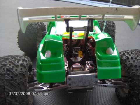

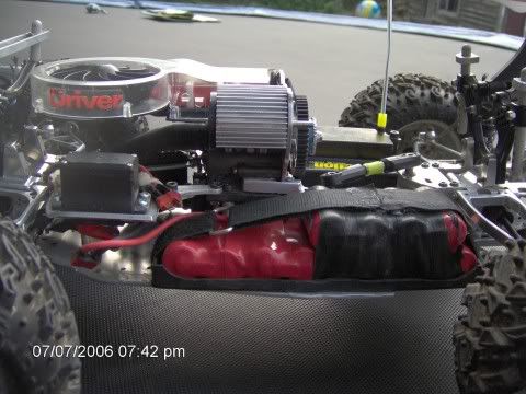

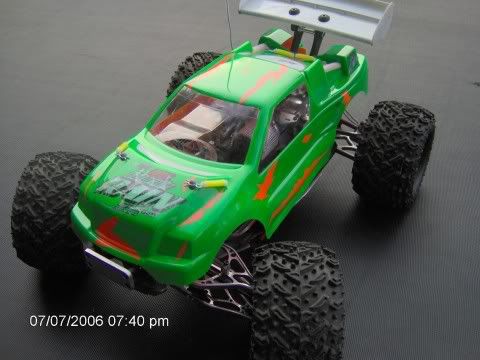

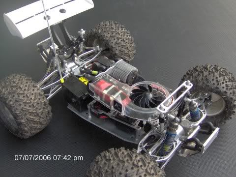

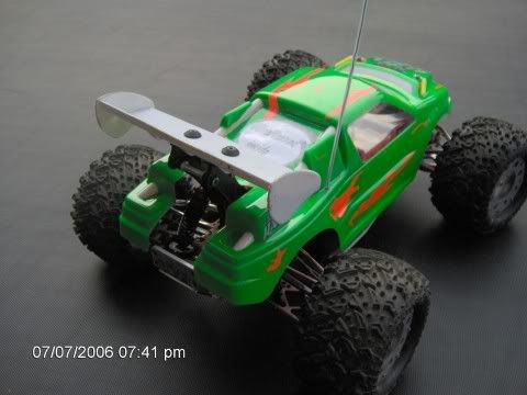

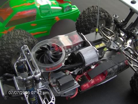

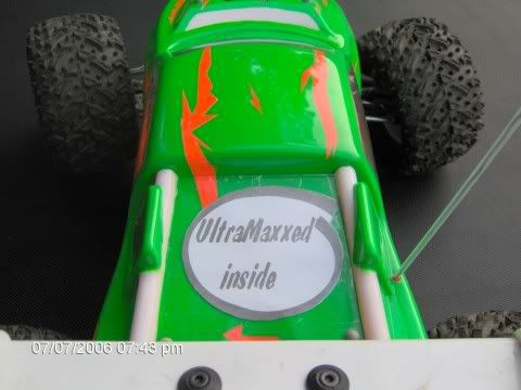

Here are a few pics of my jammin body on my hybrid emaxx...

MAN! You should call that thing "The Turbine" ! Very nice! How HEAVY is that thing? Hows the 1920 run? Does the fan help alot with cooling? Very nice! LOL @ Ultramaxxed inside!

that's N I C E Shayne!

Sylvester, I like that "The Turbine"....very nice....I've ran the 1920/8 for a few years now and It runs great with my micro 2095. I'm in the middle of changing my gearing to mod1...at which time it will be 12/51.. as for the fan..the way i have it positioned it pulls air thru the controller ( where the motor wires are) thru the heatsink fins and out around the caps..and out hte top of the fan....I ran it hard for 4 packs (back to back) and the controller was still very cool. And as for the weight, I think it's between 12-13 lbs...not really sure though. thanks for the comments. And the "ULTRAMAXXED INSIDE"....I thought that would be something different.

Once again, very nice!! Where did you get that fan anyway?

Looks like a computer video card fan if I'm not mistaken? Very nice truck and good idea with the fan.

Does it come with the plastic? Man id love that for my 9920 so in the 30C+ weather wont thermal my esc. Does it take much juice from your batteries or what?

yup it sure is....it took a little fabricating and figuring out how to get it placed inside correctly, but it cools it very nicely.

do a search for one of these on ebay....here you go...
http://cgi.ebay.com/ARCTIC-COOLING-V...QQcmdZViewItem
or search for one of these...
ARCTIC COOLING NV SILENCER 1 VGA COOLER
