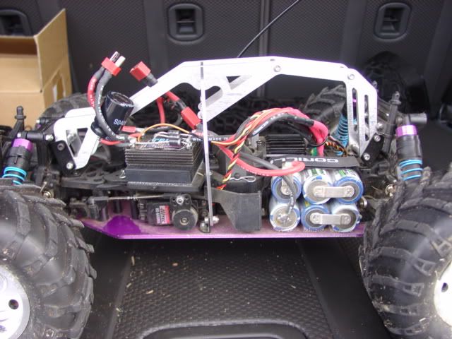

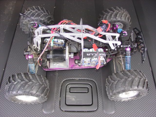

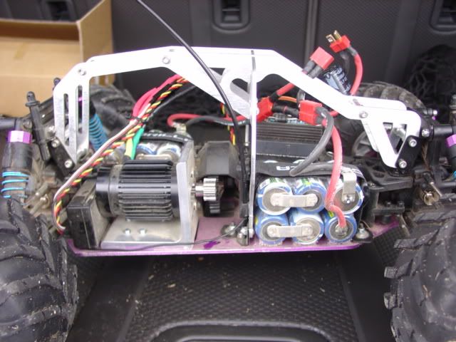

This is my first attempt at a brushless conversion, but I think it turned out rather well. I’ve wanted to do one for a while. My other R/C, an electric Stampede, is fun, but I wanted something 4wd with better handling to supplement that 2wd tipsy beast. I wanted an electric truck, of course, but the 4wd electric stadium truck is extinct on the market right now. So, I made one myself. I was actually inspired by camel_rc’s MT2 last year, but I challenged myself to fit an even bigger motor and more cells on that tight chassis.

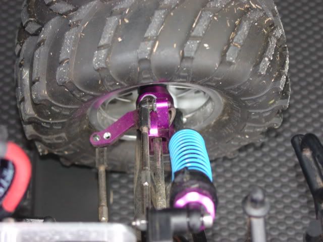

I hunted for a used MT2 18SS for a while, and finally found a good one. It even came with a Hitec 645MG servo for the steering. Bonus! I sold all the nitro goodies for my brushless fund, of course. I wanted to make the truck really strong for bashing, so I upgraded some of the MT2’s weak areas. Most noticeably, I installed an RC Solutions roll cage to stiffen the flimsy chassis and protect my valuable brushless system and batteries from damage. Then I installed CVD center driveshafts to replace the stock dogbones. I also installed aluminum knuckles and c-hubs at all four corners to replace the stock plastic ones.

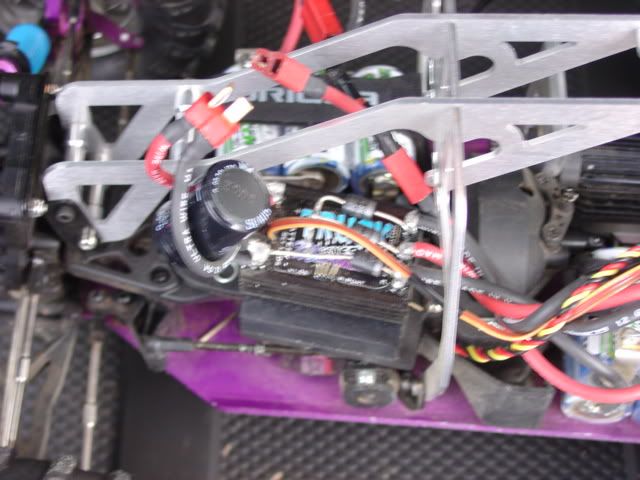

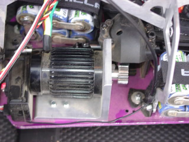

For the brushless system, I am using an Mtroniks Truck controller and a Feigao 540C-9L motor. The batteries are matched IB3800 cells from Promatch. The motor mount is made out of 2.5” x 2.5” x ¼” 6061 aluminum angle that I designed and a buddy of mine made for me at his machine shop. It is similar to coldfusion’s mount, but this one is custom made for the MT2. I enlarged two of the engine mount holes in the chassis and drilled two more. It is secured by four countersunk M5 screws. The batteries are held in place by a G3 GorillaMaxx strap and by M3 dual lock fasteners on the bottom. I was able to use existing chassis holes to bolt the straps on. To mount the servo and controller, I decided to keep the front half of the radio tray. The controller is mounted with dual lock fasteners to the bottom of a T-Maxx receiver box, which is bolted to the top of the MT2 radio tray. The receiver is mounted to the chassis with double-sided tape behind the motor. The antenna mount was removed from the radio tray with a dremmel and then shoe-gooed to the roll cage.
I drove it for the first time yesterday, and it really flies! I have it geared 49/14. The controller got warm, and the motor got really warm. The truck is heavier than stock, so the suspension was sagging a bit. I need to install stiffer springs to support the weight. I ran it with the stock Dirt Bonz, jr. tires, and they worked well. I’m going to try it with the Masher 2000’s today if it doesn’t rain. The balance of the weight seems to be pretty good, and it handles much better than the pede! I think one of the diffs is going to die soon, though. When I first started the truck, it was clicking a little bit, but by the end of the run, it was clicking loudly and skipping occasionally. I’ll buy new diffs soon and make sure that they are shimmed properly.

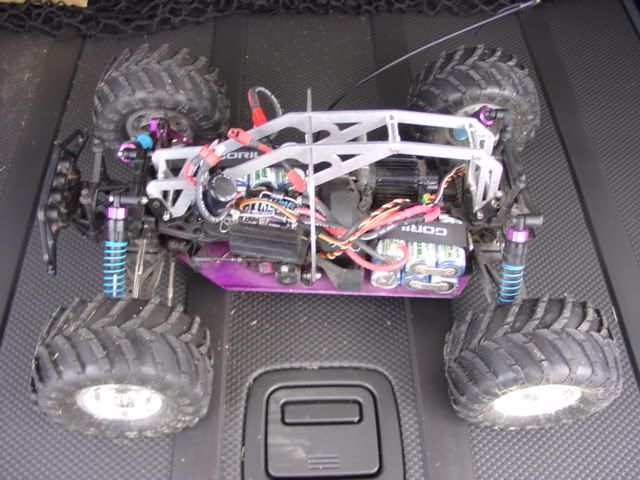

How are your Gorilla straps held in?

Check out the second picture. I used the bolt and washer that came with the straps and secured the bolt to the chassis with a 3mm nylon locknut.
