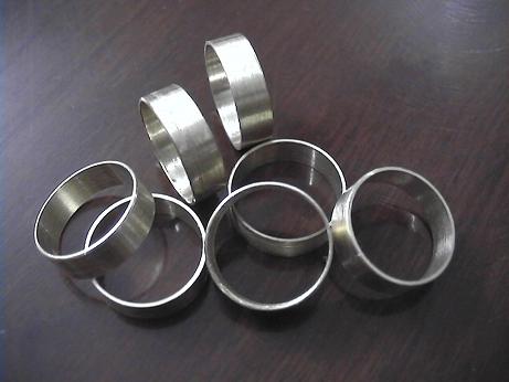

captain harlock
RC-Monster Captain
captain harlock's Avatar
Posts: 2,745
Location: Saudi Arabia
08.22.2006, 02:34 PM
I managed to go to a lathe shop and asked them to make me some 1mm sleeves to make the 15x6x5mm ceramics equal to the 16x6x5mm UE bearings.
The results are quite nice:
Nice to meet you!
squeeforever
squeeforever's Avatar
Posts: 6,254
Location: Baton Rouge
08.22.2006, 02:39 PM
Looks good, I would possible be worried about them coming out. You might want to glue them in or something.
