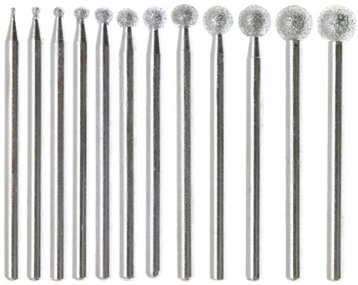

What I use: http://www.widgetsupply.com/page/WS/...set/XSW4-312DD
Works great whether there is already a flat, or not. You have to get the divit sized right for the setscrew, but it only takes a few minutes. And cover all holes/bearings with tape first. Loctite is also recommended.
