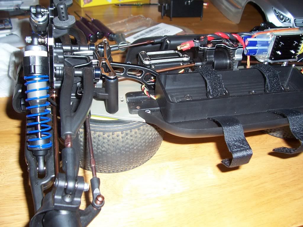

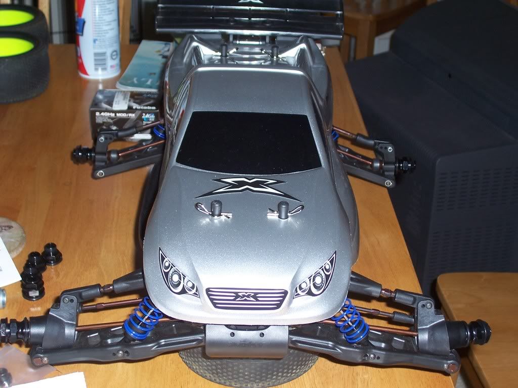

here are a few shots of my xray xt8 converted by mike and dafni. these guys deserve lots of credit, the pics don't really do this build justice! thanks again guys!
neu 1515 2.5d/ mgm 22418/ flightpower 5s evo25 5000/ hitec 5955tg steering
Photo Sharing and Video Hosting at Photobucket
body on

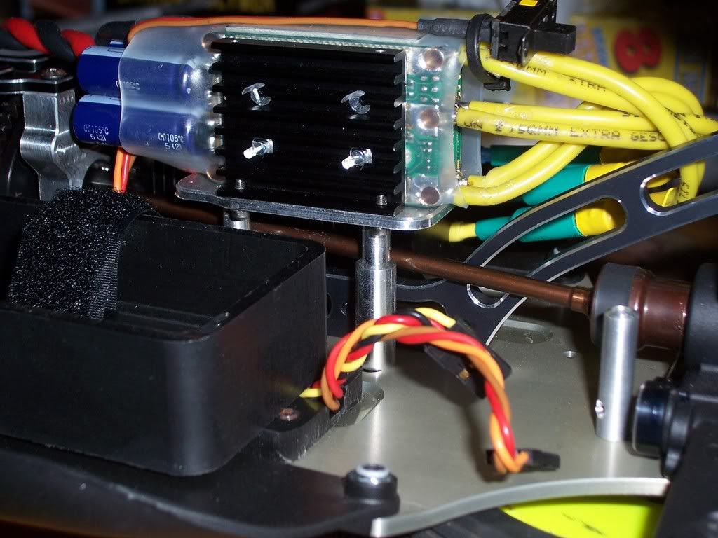

custom esc rack

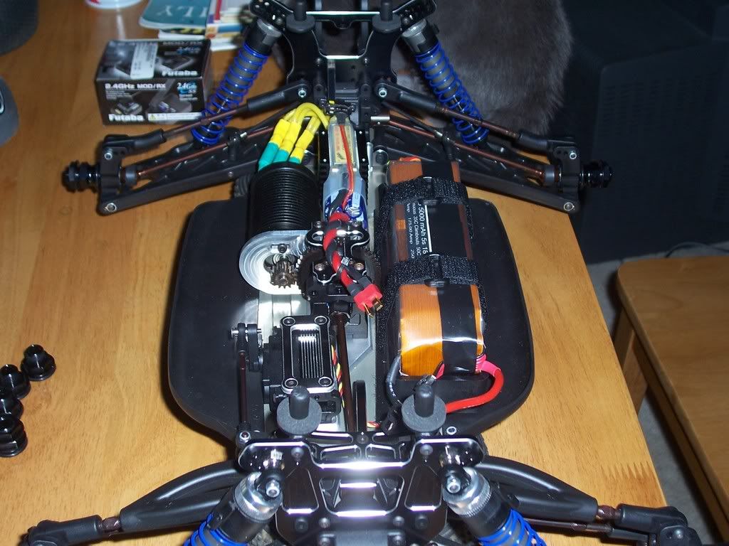

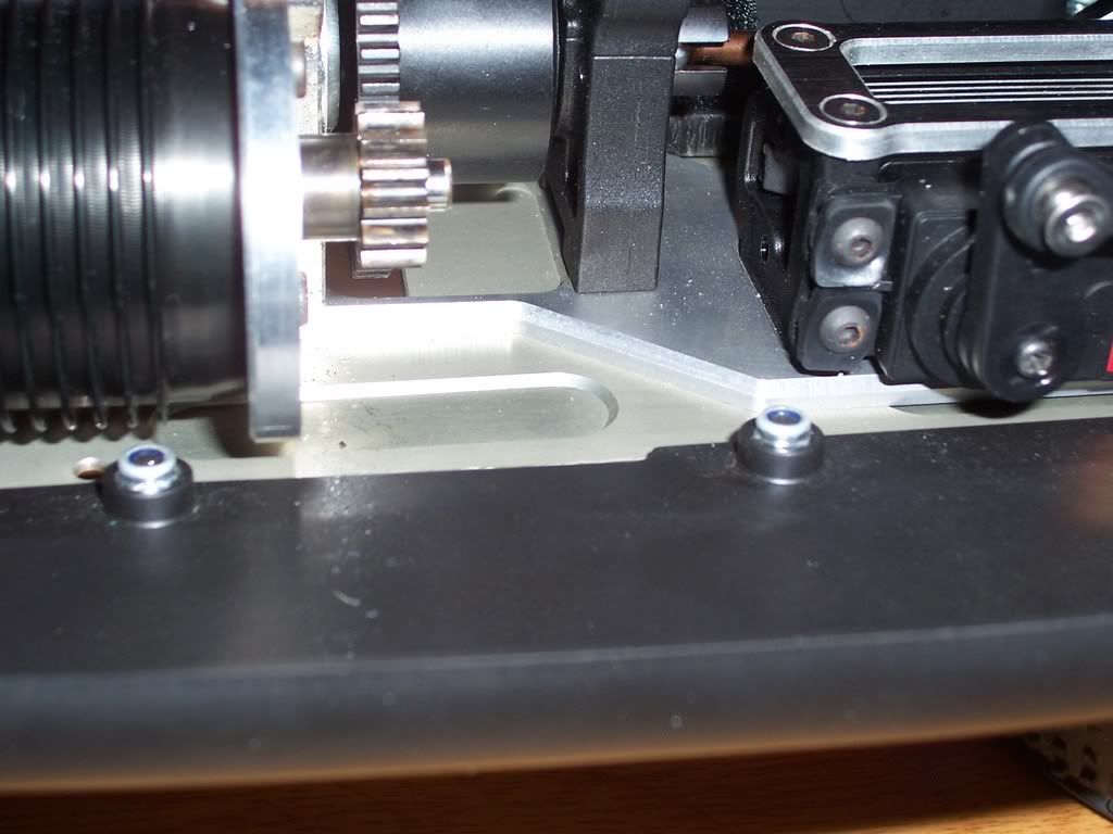

custom chassis brace

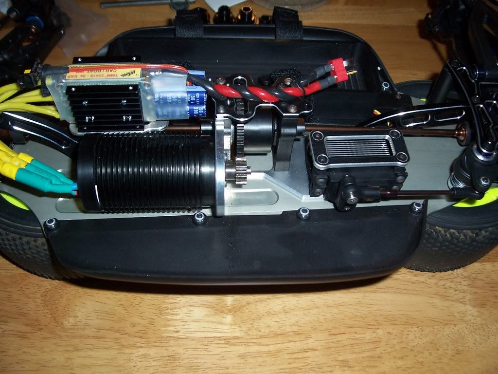

custom servo mount plate(anodized to match the rest of the truck)
custom battery tray
