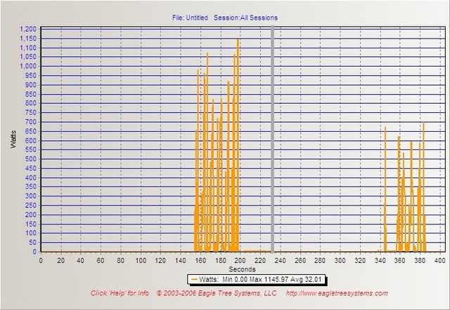

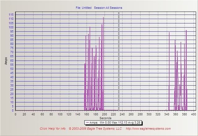

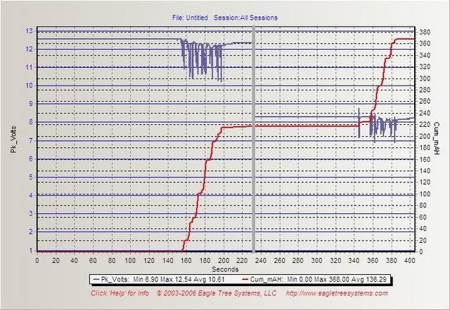

Just thought i'd show the graphs on a run, on 3 and 2s lipo's in the same run. The first part was 3s and the second part was 2s. The 2s tested was a flight power, that was fully charged but sitting for a week. The 3s was a 5000 mah maxamps
Volt drop and mah used
[IMG][/IMG]
amp peaks
[IMG][/IMG]
and lastly, watts
[IMG][/IMG]
this setup puts out really good power

Good work with the graphs. Yep, it does look pretty impressive. Traxxas seems to have done a very good job with their first foray into the brushless world.
