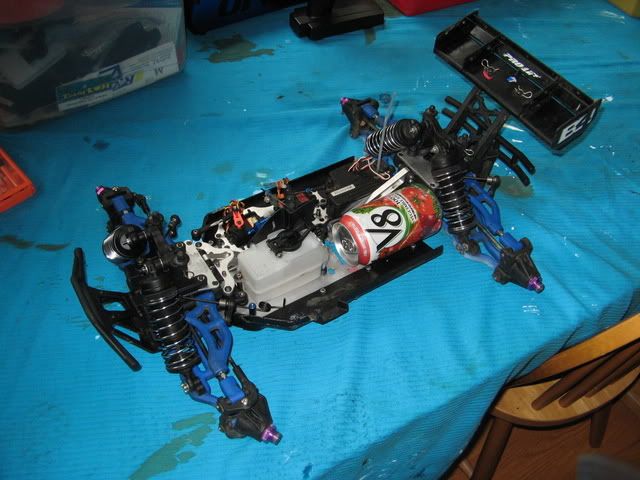

I can easily place a cola can in the position of the engine so that's about the size electric motor I could use, I want it to top 4hp or something like that so I never miss nitro. If that's possible.
I'll start getting some pictures as soon as my camera is charged.

No, it must look like this.
I don't exactly know what your saying no to, but I can assure you it won't look anywhere near that. First off, no gas tank, second, no huge motor twice the size of anything reasonable, and third, you'll need a place for the batteries, so I'm gonna go ahead and say the RX box has to go.

10.21.2007, 10:15 PM
Boy that is a Large Can size motor......
