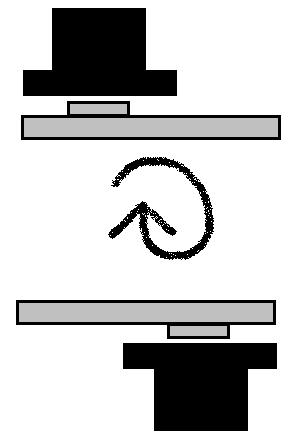

This may sound like a dumb question but: Is the electric motor/diff mounts for sale in the shop here reversible? Meaning can they be flipped either direction so the motor can be placed on either side of the vehicle.
I'm talking specifically about the one for the Mugen mbx5. I'm sure it's not, but I can't tell which way it should be turned by looking at the picture.

12.04.2007, 06:16 PM
No it only goes on one side as the bearing fits in it...
If you want some pics of a converted one LMK - I converted my MBX5 buggy/truggy

The mounts can sort of be reversed - the motor can sit in the right rear, or at the left front.
12.04.2007, 09:13 PM
I'm not sure - rotating the mount will mean that bearing supporting the diff would now be on the outside of the mount - i.e. nothing stopping is failling out.
Mile also recessed the motor mount screw slot which you would not have...

I have drawn up a quick pic. All I did was rotate the mount 180*. The view shown is from above. The top one is with the motor mounted at the right rear. The bottom one is flipped 180*, and has the motor at the front left.
