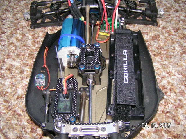

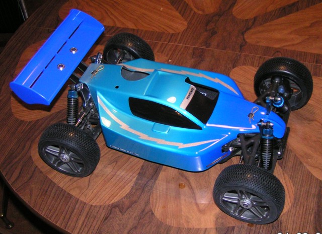

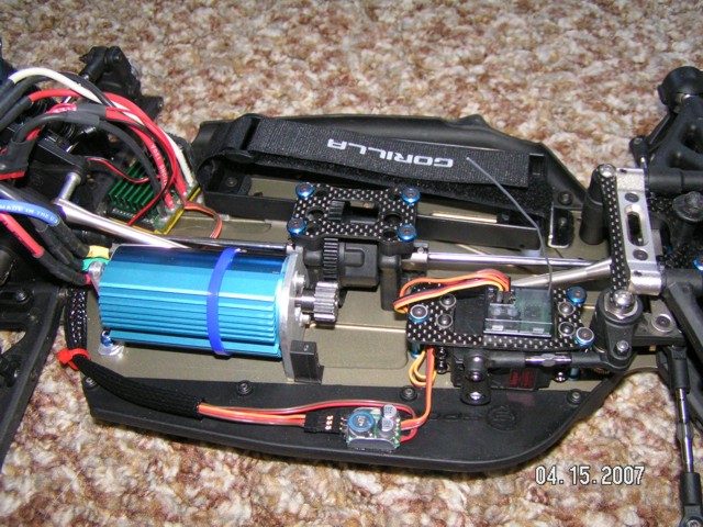

Got my first try with 4s (first 4s) on my new buggy (and first 1/8th ever). Sportwerks Mayhem Pro, Mamba max, 7xl, Maxamps 4s 5000HV. Holy cr*p, this thing flies! It is very silent too, alot queiter than my MT2 18SS conversion. At part throttle, you can hear the driveshafts clicking, but no gears or motor noise. At full throttle, it just makes a powerful whine! Whoo-hoo, this should really smoke some nitro but. The shear acceleration of this heavy (still less than 8lbs) buggy is amazing!

Thats really clean - nice job.

That's a nice conversion. The Turmoil was my first conversion.

looks like a clean conversion. I like it. what kind of bec unit is that?

AAngel: I chucked the diff cup in a drill and ran it on sandpaper to fit into a kyosho 46 t spur, didn't need much removed.
gixxer: It is a Dimension Engineering Park BEC 6v

AAngel: not sure what you mean about the bearing standoff? I did have a problem witth the screw heads not quite being flush with the spur. Ended up putting a diff shim on the outside of the rear bearing to get the screw heads away from the diff mount.

I don't think that I mentioned it before, but it looks like your running a Feigao/Nemesis motor. There are optional aluminum center diff bulks. If you use these to fasten your mount to, it will be more rigid and help to channel the heat from the motor mount, through the diff bulks to the chassis and will get you more runtime before the motor over heats.

I made the motor mount, it is just a piece of aluminum screwed to the center diff mount. I don't have any plans for it and don't plan on making any to sell. In fact I may get one from RC-Monster Mike as his work is real nice, and he does custom stuff as well.
The battery tray is a kyosho part, RC-Monster sells them (they may not be in the store, email Mike if you want one).
Motor; the XL feigaos are popular, but I am starting to think they run a bit too hot for my liking. Alot of guys on here are going with the Neu motors,as they are much more efficient. 1700 to 2000 kv seem to be the most popular
Pinions I have been getting here at RC-Monster. Gear for the speed you want (use BrianG's calculator), most are gearing for 35 to 40 mph for racing.
Spur gear is also a Kyosho part available here at the RC-Monster store, it is plastic and allows the use of non hardened (cheaper) pinions. Some have used the stock spur gears, but a hardened pinion would be required for that.
BEC is a Dimension Engineering ParkBEC. It was smallest lightest one I could find, but if running high torque digital servo, I don't know if it will be enough. I have no prob with my old Hitec605MG in there.
The biggest thing you have to do is get rid of the nitrocrap. The servo plate will need to be cut so you just have the steering servo mount and no throttle servo. And of course bolting on you motor mount and battery tray.
