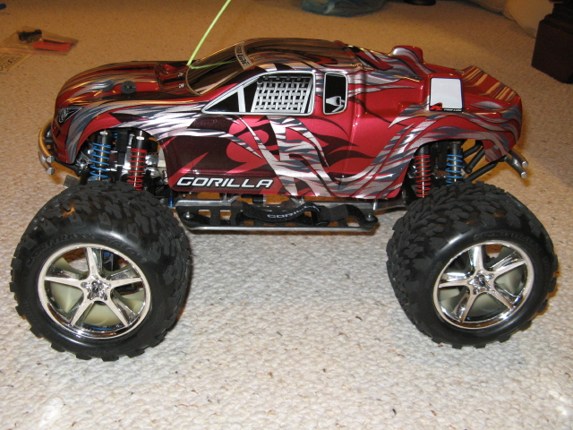

well, i finally took the plunge and upgraded my gmaxx to brushless through help of this forum. boy, going brushless is just ridiculously fun. i never thought my truck could go this fast. now, i understand why everyone raves about brushless power.
set-up:
-gmaxx
-g1 single speed with rcm steel idler
-BK 9920/8xl
-UBEC
-16 cells
-maximizer diff upgrades
-strobe 51/18
-countless other upgrades too long to mentioned

Congradulations, brushless is true power. Now start saving for a couple high quality lipo packs the power increase will be noticable

We're all strange around this place. Is it just me, or is the tranny facing the wrong way on that truck? I assume the diffs are flipped too to compensate.

Or, he could have simply swapped any two of the motor wires. Much simpler and easier, unless you REALLY like useless tinkering.

Or have a Novak system, you have to flip the diffs if turning the tranny around, the wires have to be in the correct order for it to work.

Yes, but I made sure he was using a sensorless system (in the pic).

He may have flipped the tranny to provide more room and/or balance for mounting other components.

yup, i flipped tranny as i thought it was a cleaner look and to provide more room to mount my electronics in the front. i was able to reverse engine by just reprogramming the BK ESC.
next big purchase would be lipos. but man, are they expensive.
