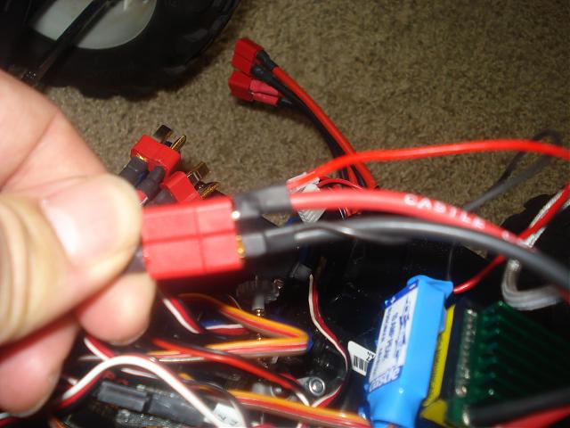

here is what im talking about.. hope this could help me..OK,, I dont know why its not working but here what I did.
Im using 2 2S 4000 to make up 1 4S in series.
I did what was told to me and nothing works now.. I took out the red wire from the esc and put that into channel 2, and bec into channel 3. Now, nothing works. Before when I took out the red wire, I put the esc plug on channel 2, and bec on channel 3 plug, and everthing worked except that i didnt know where to put the brake servo wire. When I got the Bec, the cover showed to put the esc into 2, and the bec to 3 w/o any ommission of the red wire in channel 2. When I look into CC website, it shows to take out the red wire in the ESC plug.. Now im confused.. here are the pics..
any help is appreicated.. thanks,

OK on your pics, all seam to be OK, but please, ISOLATED the red wire, if this wire touch to your heatsink controller... bye bye the internal BEC!!!

I will isolate that, but nothing works.. i tried this b/4 and nothing works.. is my bec a dud?
