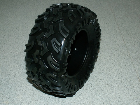

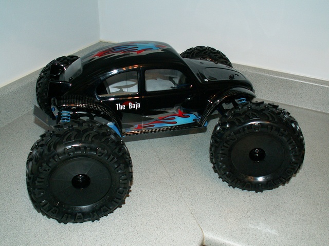

Here are the results! Beside my komodo's to compare.
ID:	3766   Click image for larger version

By the way for people who are fanatics about specs like me the Proline are way off in there specs for the MOAB XL.
here are the quoted and real specs:
height: 7.31" -----> real is 7" !!
weight: 220g -----> real is 260g !!!
width is as specs at 3.4"
But I still saved a lot of weight by mounting them on LPR instead of the beadlocks and the tire + rim weight is 320g witch is about the same as a standard e-maxx tire/rim combo! I think this is really a good basher combo as it's not heavy like other big tires and is still 7" tall!!!

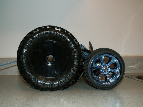

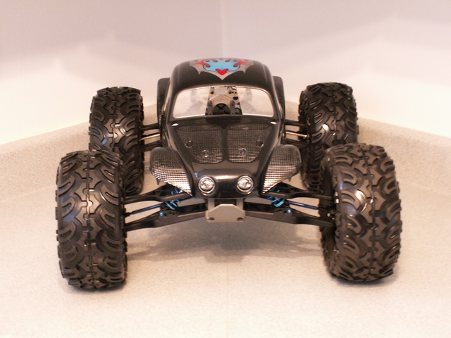

here is what is looks like with my Gorilla E-maxx! and by the way the wheelbase is 13.7 but looks like 12 with these tires!
ID:	3840   Click image for larger version

01.22.2008, 02:54 AM
you need to swap your tires boy!
front right with rear left
Looks massive.
superlightmaxx
superlightmaxx's Avatar
Posts: 118
01.22.2008, 12:07 PM
lol thanks, I just put them on quick for the pics and didn't even realised they where on wrong :O)
