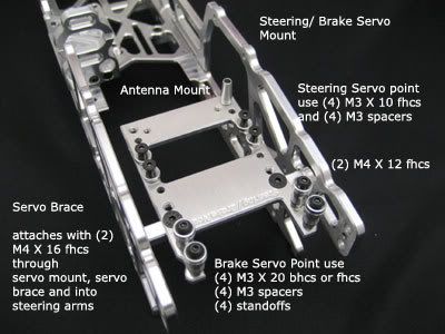

I think I may be missing the servo brace mount. It is the piece that goes across the tvps and the servo plate mounts to it and holds the top of the steering posts. Any chance someone could get me a pic of it? Here is a shot of it from the top for FLM. It would be nice to see what it looks like!
Also the holes on the center plate that should line up with the tranny are off by about 3/8". Not really an issue but I figured that I would mention it anyway.
The far right holes on the little legs that stick out are the ones I am concerned with.
Sorry about the images not coming up, no idea why?

that brace is nothing more than a 74mm wide aluminum square part of about 7X7 mm
You can also use one of the standard braces you used with the nitro motorplate; you only need to drill the M3 holes with a 4 mm drill.
I can't wait to get mine and get a proper instruction ready.
I assume Jamie used the old TVP's as a template, if he did, their was a small issue with bolting in the transmission to the TVP's (room was a bit too tight) it all falls in place if you tightened the screws, but it could be a bit better. I can imagine if these screws aren't tightened all the way, this would give you the miss-alignment as described.
I hope you get my drift on the motorplate thingies. The HPI partnumber is hpi86063 for the older .25 models, the X braces have got a notch in them to allow clearance for the driveshafts.
