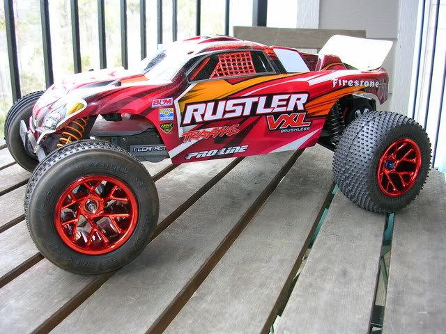

Dyed a set of BIG wheels for the first time. They turned out pretty well I guess. I'm going to dye a set of chrome wheels next. Wish me luck.
The paintjob was only my second attempt at painting lexan. I literally had it purchased, prep'd, painted, and peppered with decals in under 24hrs. It was to be my bash body.

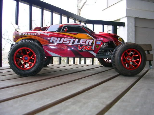

03.11.2008, 07:46 PM
Got the other set of wheels dyed
Let them soak for 1hr

03.11.2008, 08:04 PM
Nice! That turned out sweet. They certainly are pimpin now!

03.11.2008, 08:29 PM
Wow those chrome turned out sweet!
That would look good with chrome dyed black. Kind of like the popular "hyper-chrome" of some import wheels. Good idea!
