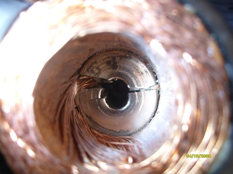

i tried spinning it and it it completely stuck, so i took it apart and the center/ second magnet it completely shattered, oh yeah i was running the pinion but i agree not much load, but i dont understand how 1/4 throttle can even cause a magnet to shatter, i just wanted to make sure that it still moved at all.

With out load the motor can spin up very quickly, even with low throttle input. That sucker is toast, time for a new one...
