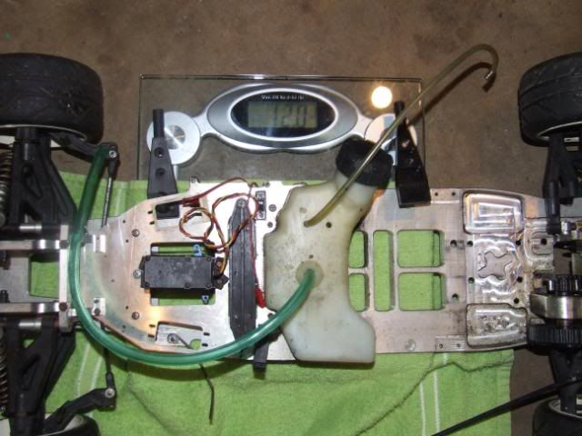

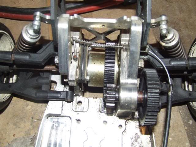

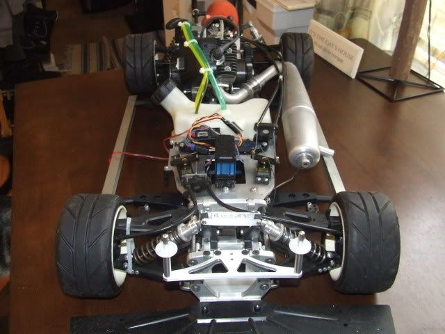

I havent read anything about battery powered speed records in the 1/5 you should be him, but a few months ago cruising the net I saw the HARM electric LINK and although its slow and has a small engine I was thinking about that Pletty Bolido and one of my 1/5 bergonzoni gas cars I smashed up pretty nicely. With the engine off it weighed 12lbs and had a some more to shed. Only issue looks like getting the motor close enough to the spur bigger pinion I dunno,never got around to it, almost all of them that ive seen have the rear end set up the same. Those FG competition cars on that site look light, more carbon less aluminum Some pics

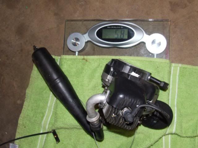

as for the motor weight

those are 2 different ones in the pics both bergonzoni .. i was thinking about a bolido but got playing with my emaxx too much and dont really have anywhere to run a 1/5 it if i did, not that I ever ran them much.
I never found the bolido specs and didnt know if it was fast or a torque machine cuz I cant speak german lol
