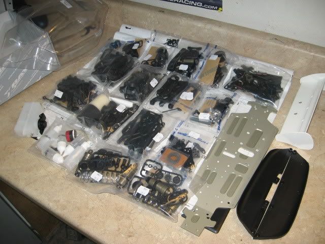

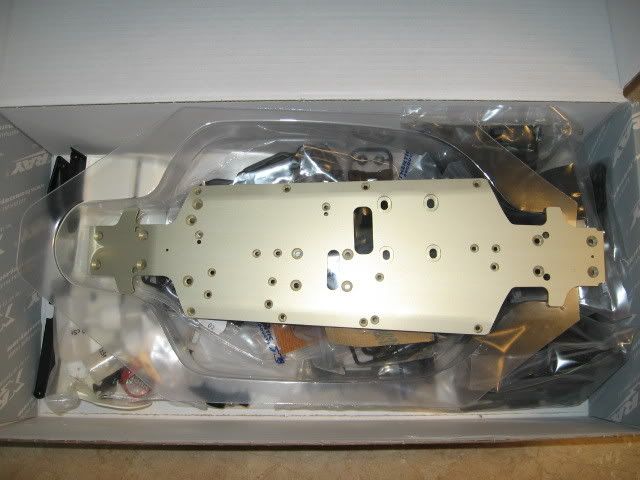

Opening the box. (First impressions) Daaammmm… (I love the smell of new parts in the evening!)..

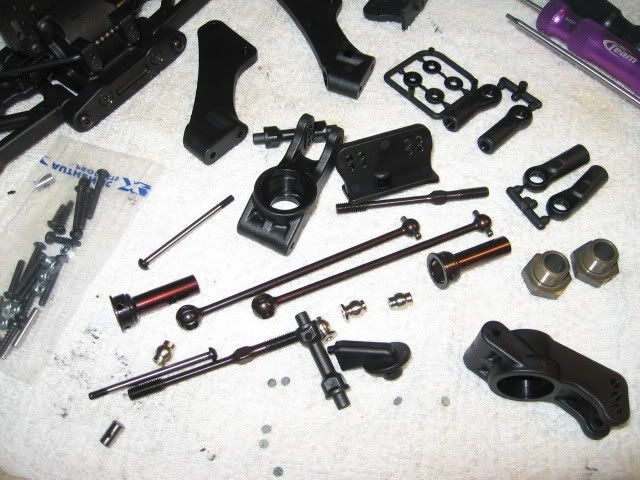

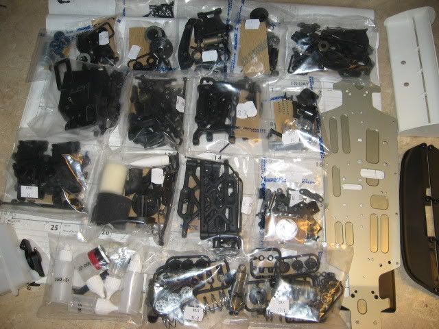

Here is what all of the parts look like all laid out. (This is going to require some thought!) I may have to actually read the instructions (NNnnnaaaa..).. I’ll just wing it for now..

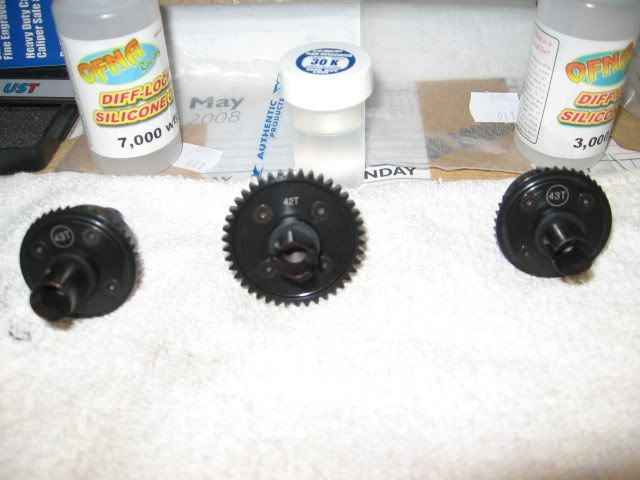

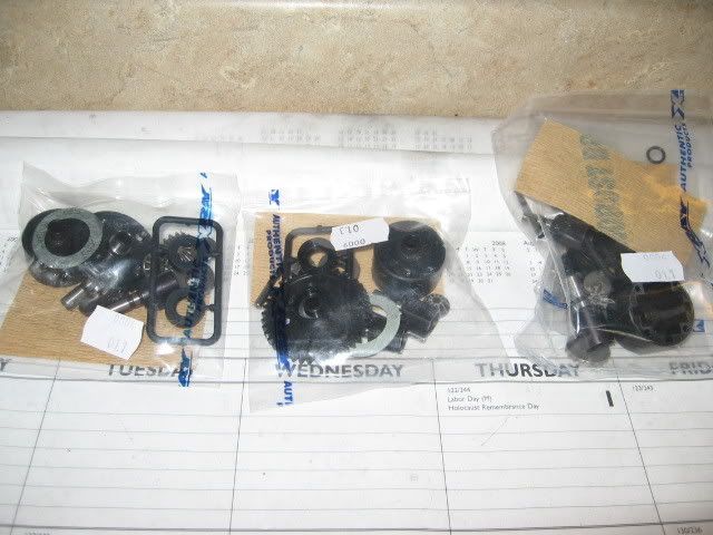

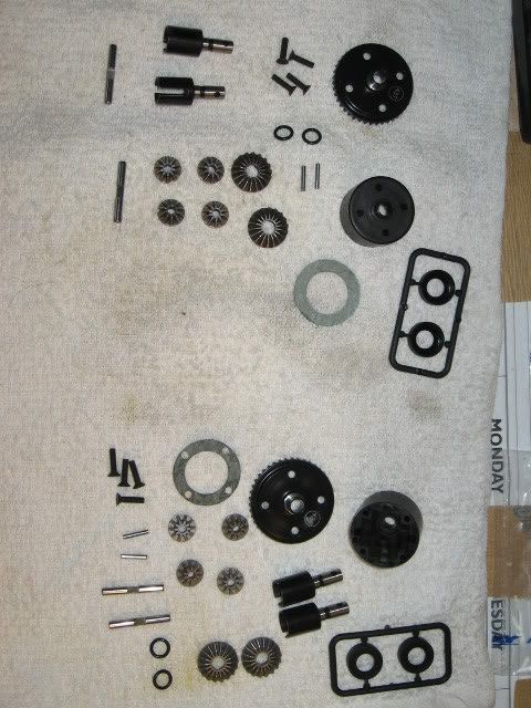

Well lets get started shall we.. I think I will start with the Diffs and a screwdriver! (What??) 

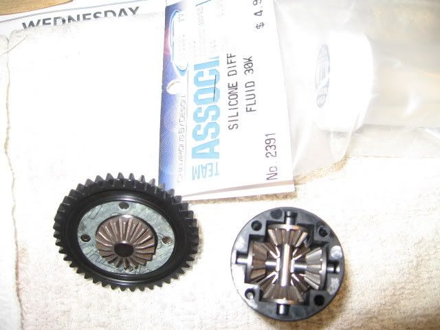

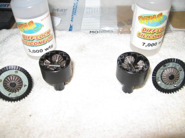

For starters I'm using the following fluids for the diff’s (5000 in the front & centers and 3000 in the rear) I'm also using a mixture of 60% Kettle one with 40% orange juice for the screwdriver..
I'm also going to (lightly sand down the tops of the diffs to ensure that they won’t leak. (Lightly is the key word here gents), just enough to take the shine off them to ensure that there are no high spots.
Nothing!.. Hahahahaaa..

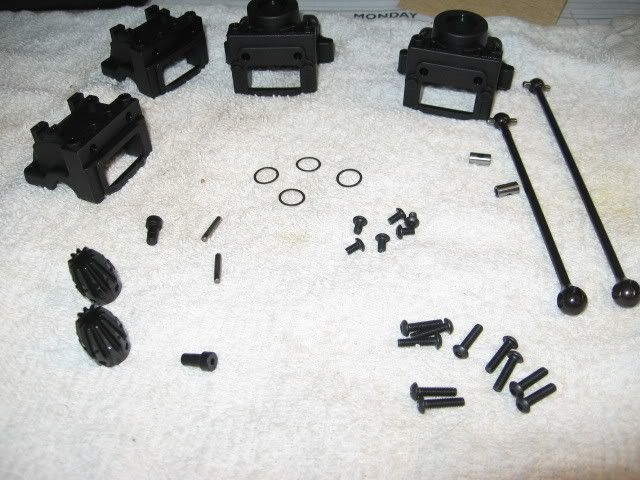

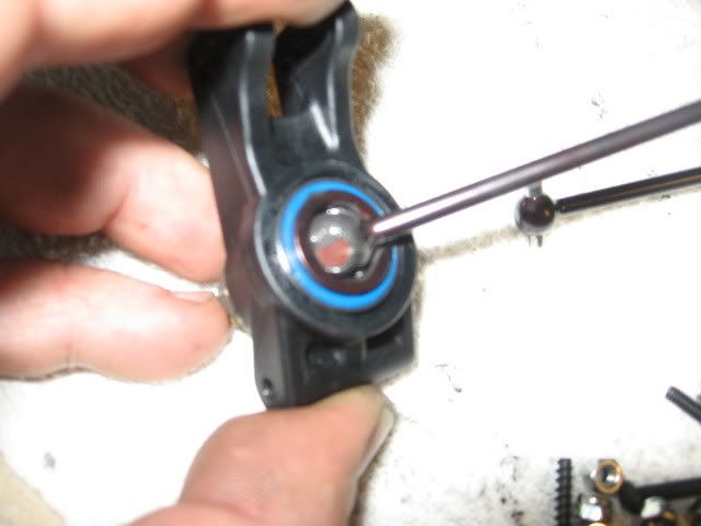

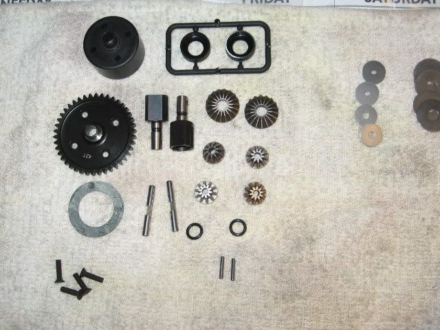

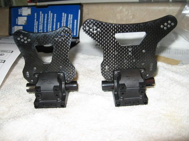

Good news!.. These bad boys go together like the one’s I'm using on my GR3 & G3 / the ones Mike sells in his hybrid diff’s kits.. (no worries)..
Well here are the diffs all completed and turning smooth… time for a refill and the next step…
Here is a part that I hate doing, but since I'm killing brain cells tonight I thought I might as well continue down that process. I’ve decided to seal all of the carbon fiber edges. (Good times) NOT!.. I'm just using my trusty cotton swabs, some CA glue and rubber gloves. I'm using the cotton swabs to ensure that I apply the correct amount and obtain the proper coverage throughout all of the edges..

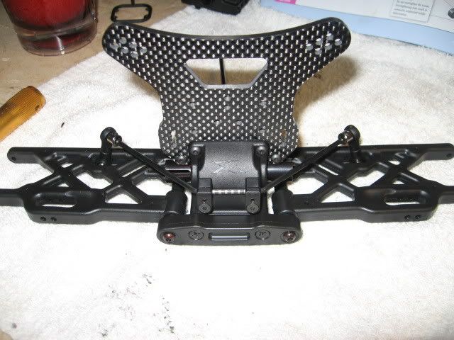

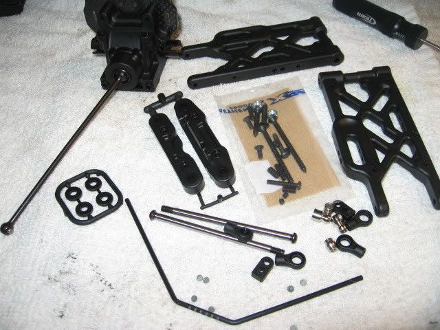

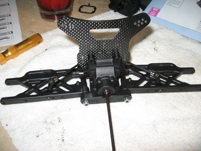

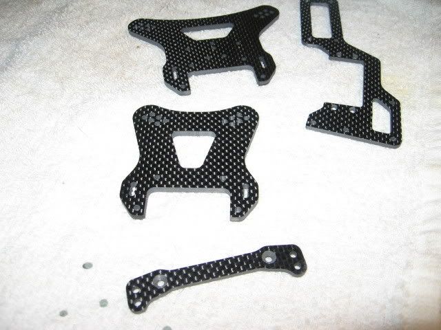

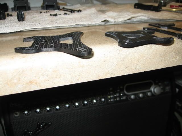

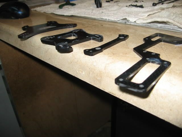

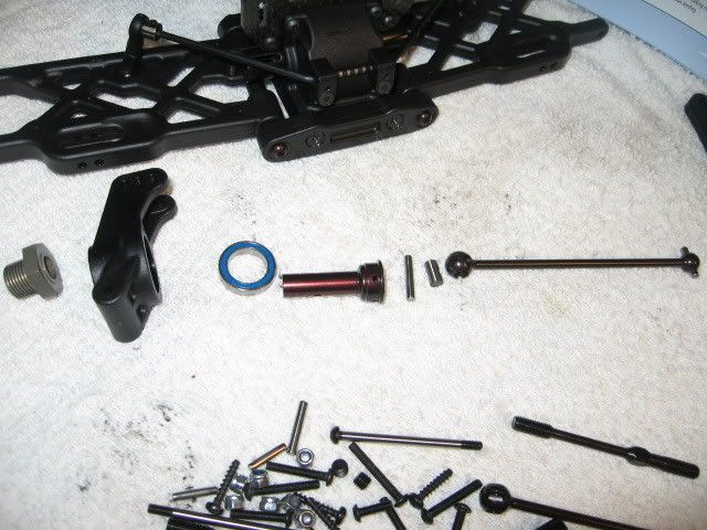

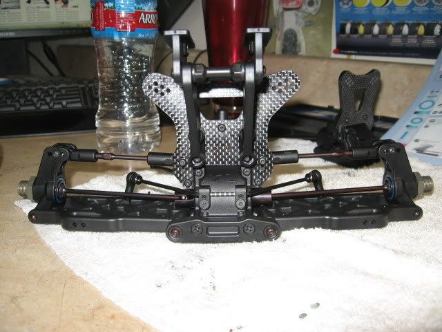

Ok, all of the CF parts are done (nice and shinny!) OOooo shiny edges!!!, It’s time for another re-fill and lets move on to the…….. HUBS… sure why not!?. Well after a quick glance at the manual (yes I opened it!) I need to do the front transmission now!. Wow this detailed, better review the manual for a while to ensure proper installation techniques are used..
Ok were making some progress now!, let’s see next I’ll install the A-Arms for the rear suspension, better do another refill while I'm at it.. Here the setup in it laid out format.. (Rear) Oooo the rear sway bar is included so I guess this will be going on as well..

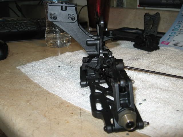

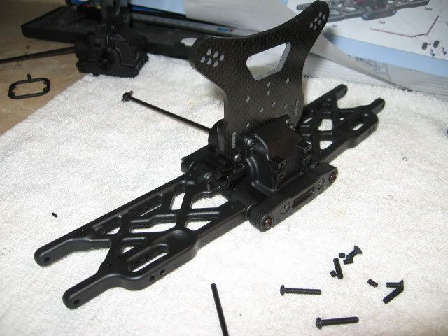

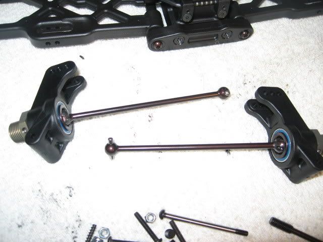

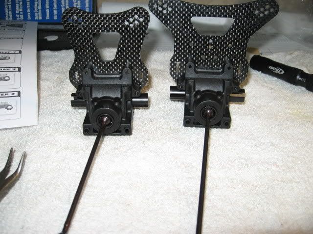

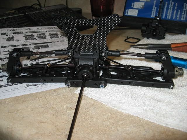

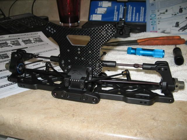

Ok the A-Arms are installed now lets move on the rear drive train and the wing mount.. Dang there are lot of parts in this bag and it’s getting late wish me luck.. better have one more re-fill for the road.
Ok the rear suspension is complete..
I'm going to bed.. thanks for looking and please feel free to leave any and all comments that arise during your review..
