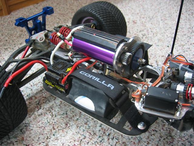

I put a triangle 3cell pack on my G3R chassis with no problem. It's the perfect width and the velcro straps hold 'em down fine. I run a 3cell pack on each side.
Here's a view before I got the velcro straps installed:
What motor do you have? How long of run time do you get with a setup like this? I saw on A123's web site that you could do a 15min quick charge. Is that true?
That's a Feigao 10XL motor. I get about 15-20 mins runtime out of them.
And yes, if you can charge them in 15 minutes. I have a hyperion 1210 charger and it'll charge the pack at 10amps and be done in about 15 minutes.

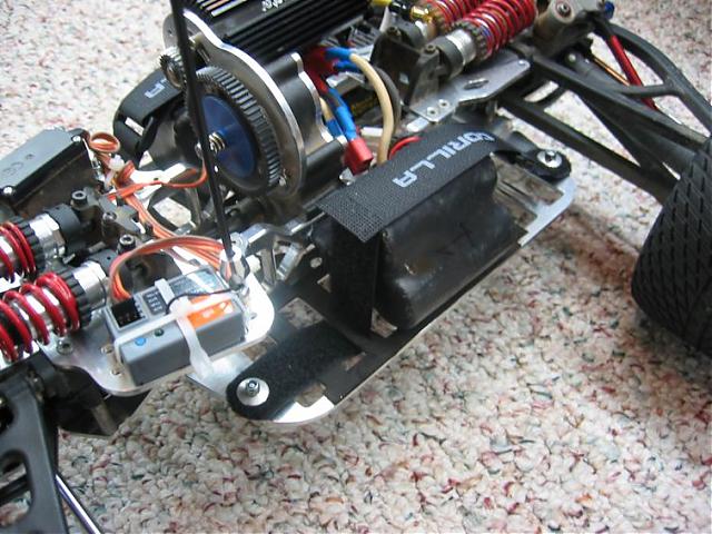

Could you offer some photos? Thanks.

06.01.2008, 09:22 PM
Here some new photos I just took.

06.01.2008, 10:00 PM
I ran 5s on each side today... Cells are a little long but it worked ok.

Gallagher
06.02.2008, 01:11 AM
They look so huge and almost as high as the upper deck.
How do you fixed the 6s pack? With straps?
If with straps, it seems difficult due to the triangle shape.
I am planning to mount double 5s.
06.02.2008, 01:22 PM
Mounting triangle 6s packs will be done with the stock Gorillamaxx straps, or something abit more heavy duty if I feel the need. A strap or two running across the packs would be much more secure, just need to find something suitable... **to ebay he went, with a smile and cheer**.
