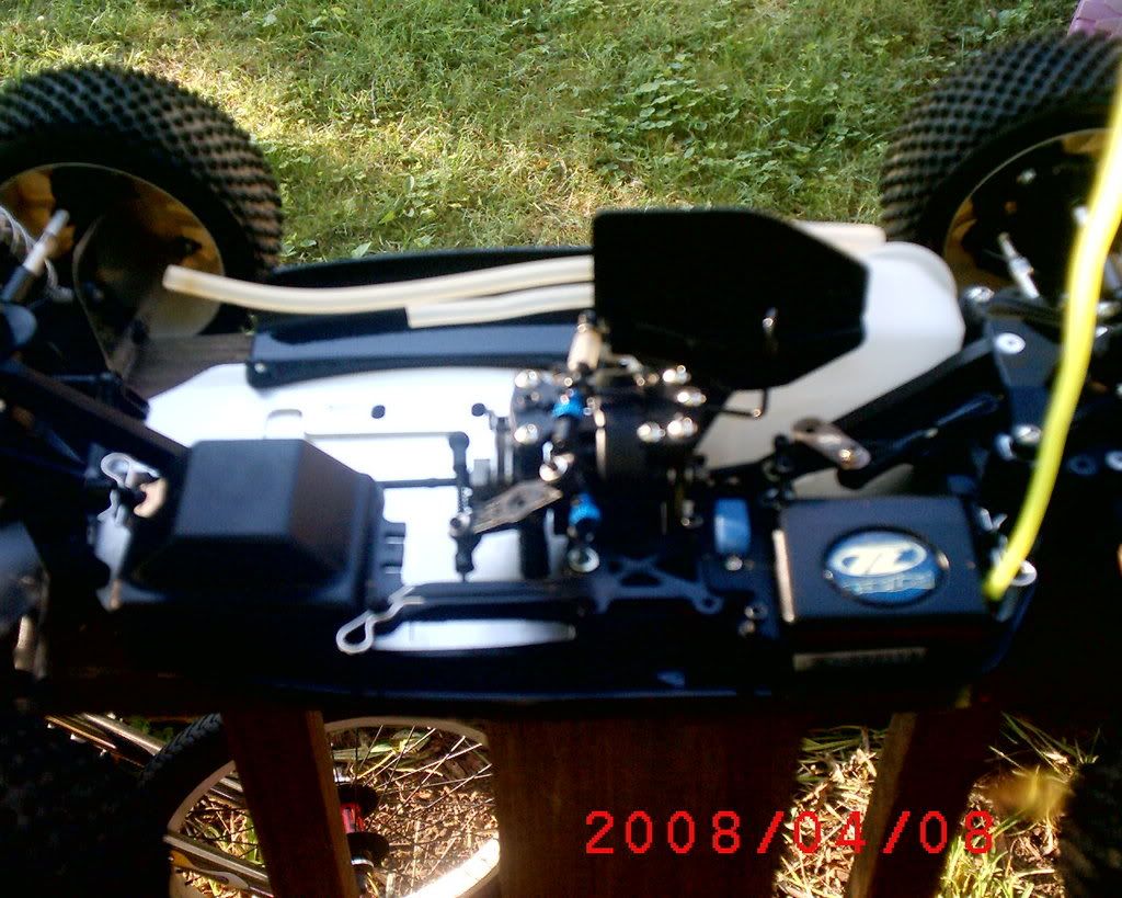

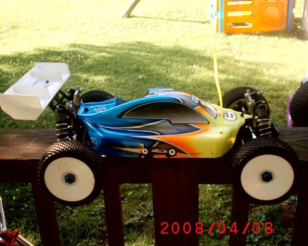

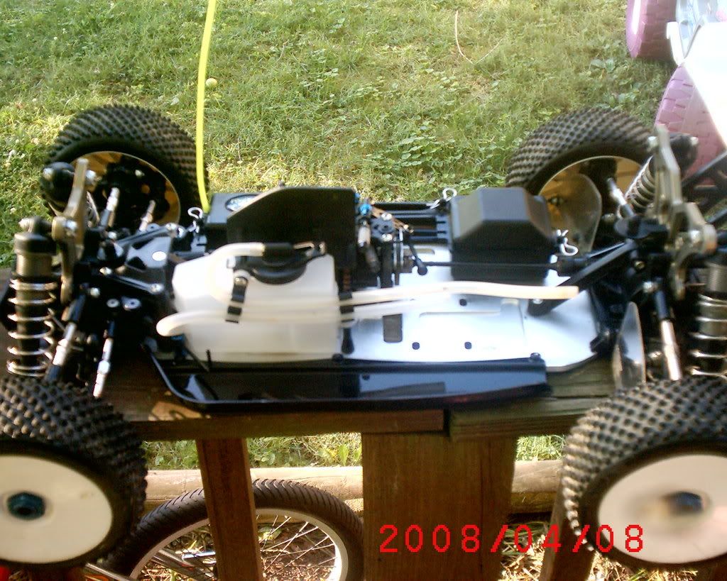

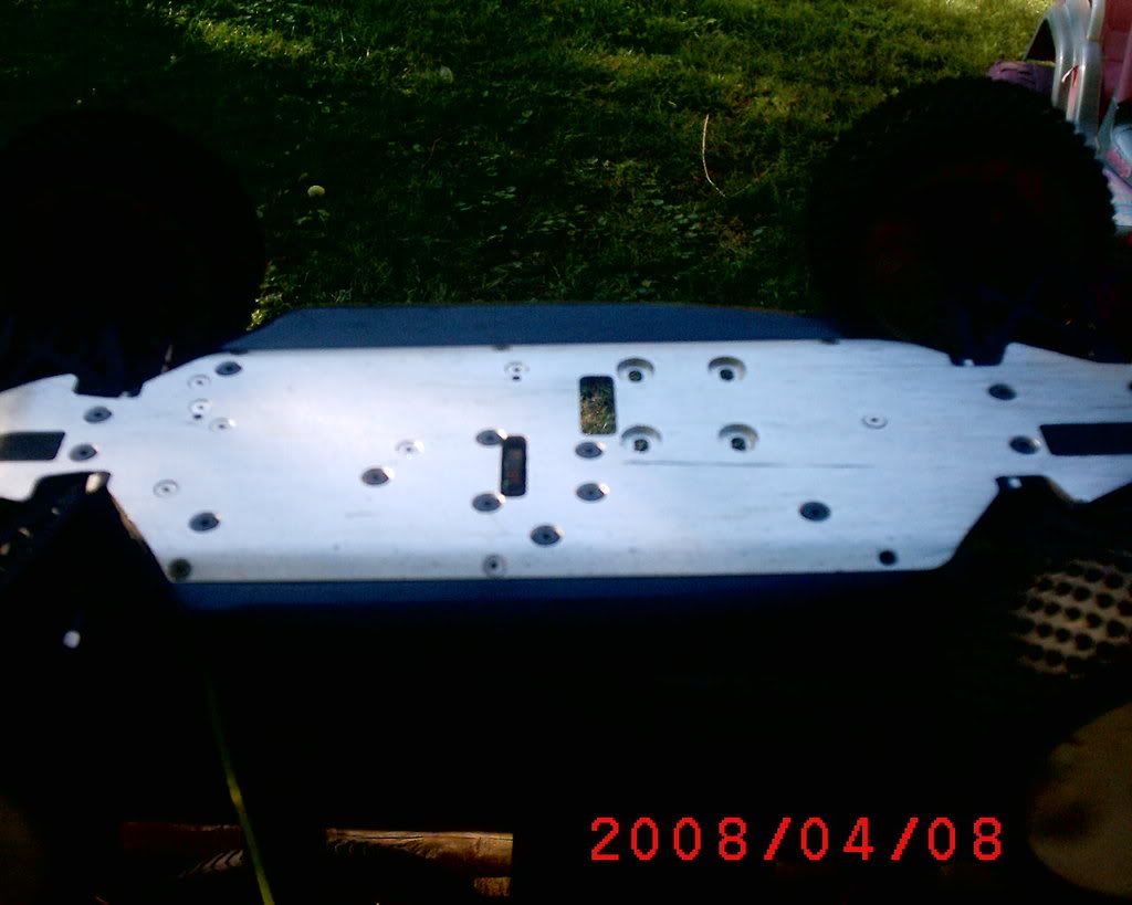

For now here are some pics of it from the guys whos sending it to me...
Once I get it in the mail i will be ordering the RCM mount for it. I already have a spare 600xl custom delta 5 wound motor coming in the mail tomorrow Ill stick that in their aswell. Ill let you guys know what happends.

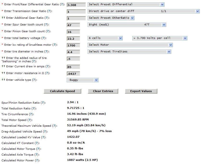

uh one thing, on the calculator, your spur and pinion values are swapped...
Yeah, and you also used 43 as the diff ratio instead of 3.3. Are you sure your buggy tires will end up being 7.1" in diameter?

07.11.2008, 10:13 AM
Looks like you need a 12t pinion to go 45

07.11.2008, 10:15 AM
Yep just fixed it Ben. Ilpufxit, I meant patients as in not being patient...

You do realize your tire size values in the speed calculator are way off, right?
Buggy tires are typically 4.5-4.6" in diameter and there is no way you'll balloon buggy tires 0.9" in radius without ripping them off the wheels first.

07.11.2008, 10:24 AM
yeah most buggy tires are 4.9 ish mine were 4.6
and 2 inches taller cuz of balooning? doubt that

07.11.2008, 10:26 AM
Skellyo, I dont use the calc much so and i've never had a 1/8 buggy so the tire size was just an estimate by me. This is actually the first time Ive used it in one of my builds. BTW its fixed...

07.11.2008, 10:28 AM
I think everything is fixed now. Am I correct?

07.11.2008, 10:29 AM
thats why there are presets....
