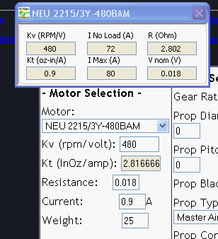

Better picture can be obtained from motorcalc or my program.

The Kt in your program for the 2215 series is opposite. It should be:
Kt (InOz/amp):
2215/1Y- 0.938
2215/1.5Y- 1.325
2215/2Y- 1.802
2215/2.5Y- 2.253
2215/3Y- 2.816
