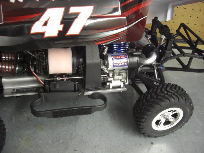

Well, I had to take the plunge.
Was so close to buying a Slash but was not impressed with the 2wd aspect of it.
When I saw that the slayer was based off the Revo chassis...I just had to have it...there is no better suspension geometry out there...
Under the hood is a beautiful thing...yes a 3.3 Nitro Motor on this thing...
Bought my Wife a Rock Garden :027:

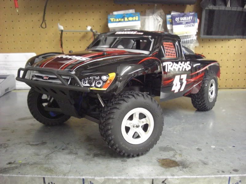

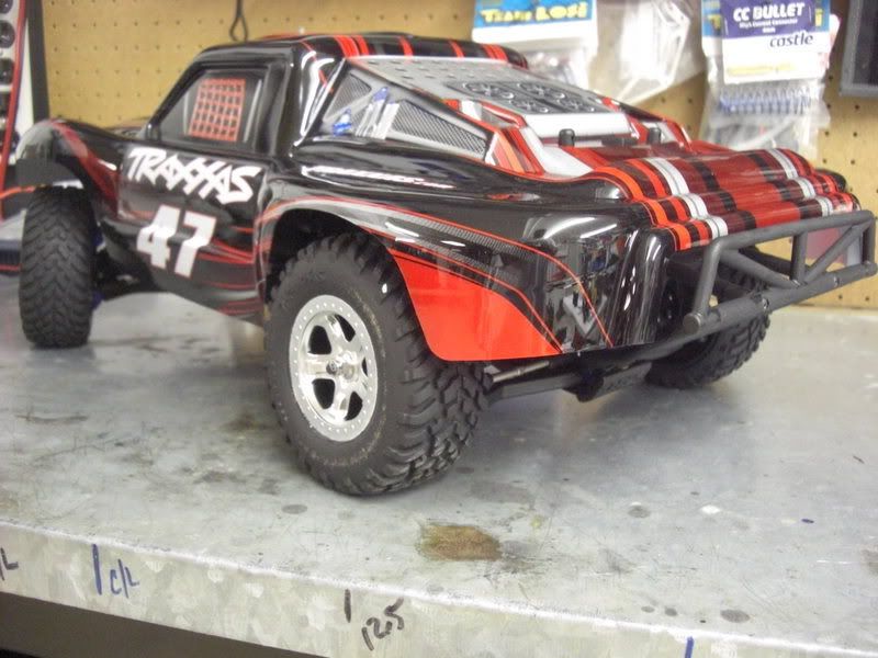

OK, enough of that non-sense...
Out with the old power...
IN WITH THE NEW POWER!!!!

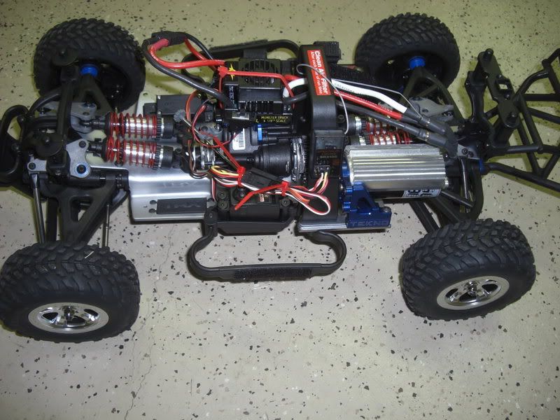

I would like to introduce you to.......
E-SLAYER!!!!!!!!

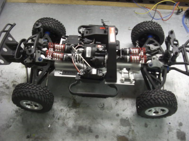

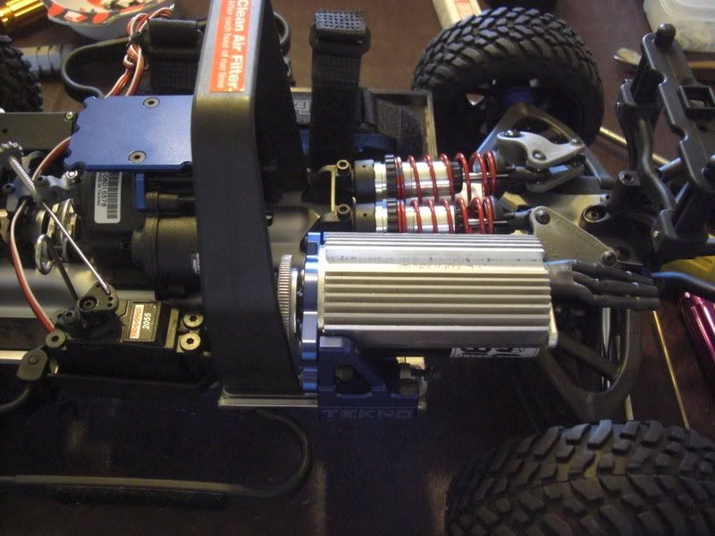

Now for the build...

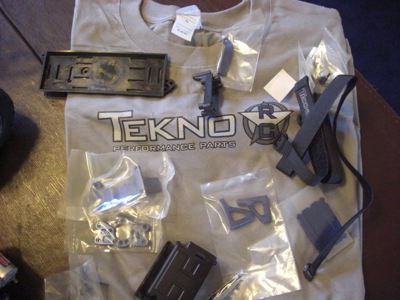

Doing some research on here it came down to two options with this conversion; 1 Build it from scratch like I did my savage or 2 find a conversion kit to help with some of the modifying.
Going with number 1 on my Savage created a lot of headaches, wasted funds and foolish purchases. I opted for number 2.
Now came the research time...I found out that the Slayer Chassis is the Revo Platinum Chassis so any of the Revo conversions should work.
I opt'd for Tekno due to the known quality and the use of the clutch bell set up. Plus a cool t-shirt
This kit includes a 5mm flywheel/clutchbell adapter; adjustable motor mount; battery tray; radio box; ESC mount and detailed instructions.

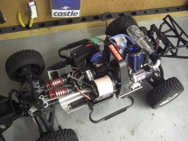

So to start you need to remove all the Nitro stuff from the the chassis which includes:
Fuel Tank, Tubing and Mounting Post
EZ Start and Wires
Exhaust Pipe and Hanger
Engine and Mount
Left Radio Box
Throttle Linkage and Return Spring
Receiver, Switch, Receiver Battery
Right Radio Box
rckcrwlr
Where are the Rocks????
rckcrwlr's Avatar
Posts: 191
Location: PA
09.14.2008, 11:39 AM

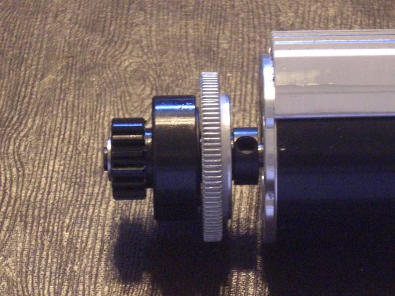

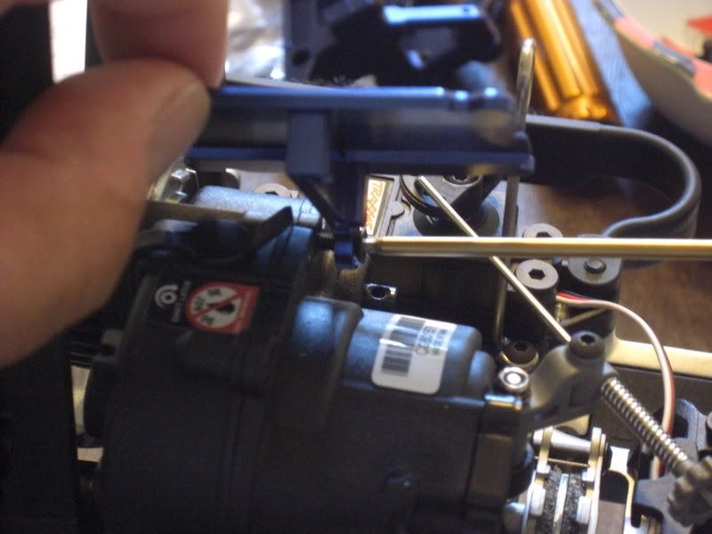

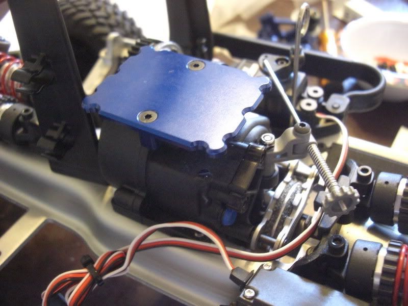

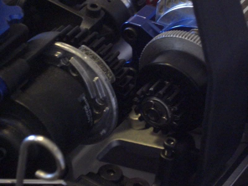

Now you need to remove the flywheel off the engine.
The kit comes with an adapter that puts the whole clutch assembly onto a 5mm shaft of a BL Motor...

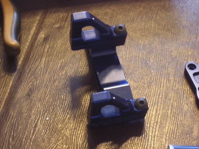

You can then assemble the motor mount. This thing lays right in where the Nitro Engine mount set. It also gives you full adjustability for most popular BL Motors up to the length of and XL (what I am using)
It also gives you full adjustability for perfect mesh setting
Once you have that set...you are home free

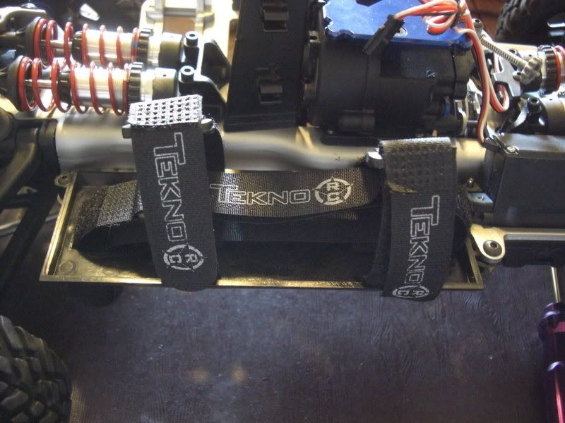

Install the ESC Mount
Install the battery Tray and straps
You are pretty much done with the conversion...

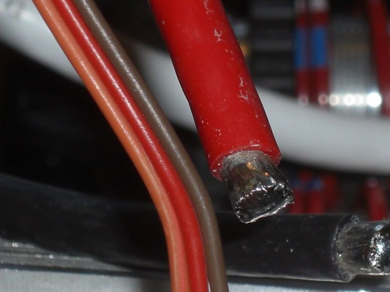

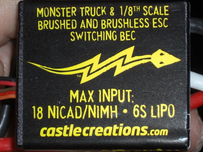

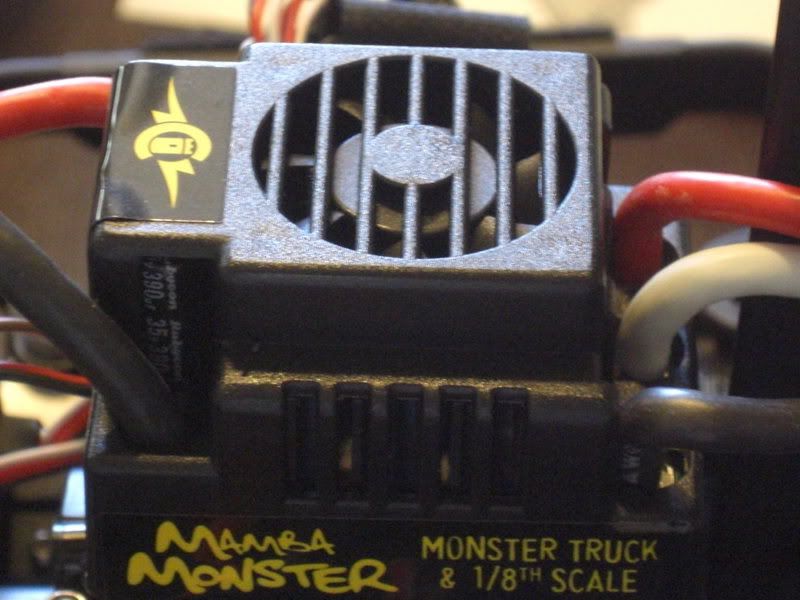

Now comes the electronics...
When you are running a nitro tranny you must use the mechanical brake and disable the ESC brake. Wiring is easy by using a "Y" Connector where the ESC and Brake Servo go in the two sides and you plug it into the Receiver Throttle Slot.
So I had this small ESC laying around so I figured I would use it on this project... :o
It is a little thing called a Mamba Monster Maxx (MMM)...check out these specs:

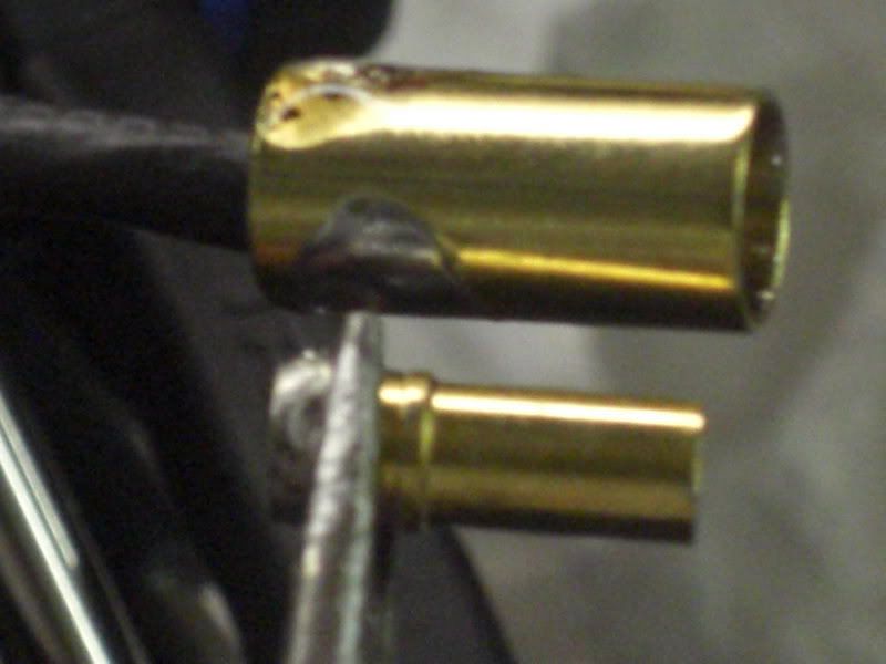

The only way to appreciate the size is to compare it. The first pic is the motor wire next to a servo wire. The second is a stock bullet plug and the one's that come with the MMM. These things are huge!!!!
It comes with a built in fan that when it is spooling up sounds like a turbine...
So she is all ready to go...just waiting on a 5s LiPo to get this puppy going...

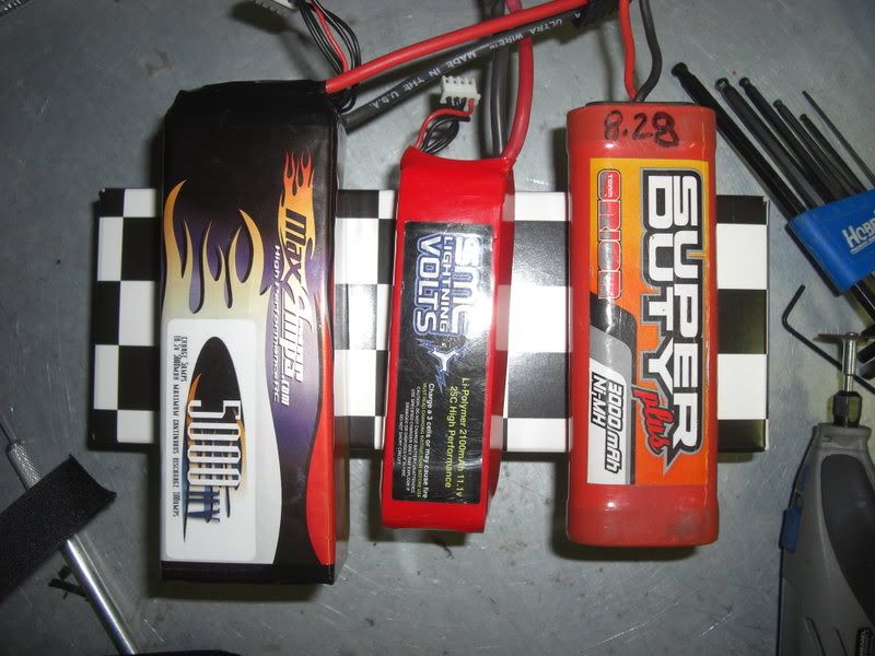

Well...bit the bullet and ordered the juice...
Thanks for the input Jason...
MaxAmps Lipo 5000HV 5S 18.5V Pack
Check out these specs:
# 5000mah Capacity
# 18.5 Volts
# 45mm X 138mm X 42mm
# 20C Constant(100 amps)
# 30C Sustained(150 amps)
# 50C Burst(250 amps)
# 565 grams
# Battery Pack comes with Hyperion Taps
# Highest performance in the industry
# Twice the capacity of NiMH for the same weight
# Plug and Play for any charger/balancer/vehicle
# We add the connectors and balancing taps for you
# Money Back Guarantee
# Normally ships within 24-48 hours
# Exceeds safety standards of the IATA
# Factory Fresh Cells within 3 weeks
# Can be recharged unlimited times per day
# Copper Tab Cells for lower resistance
