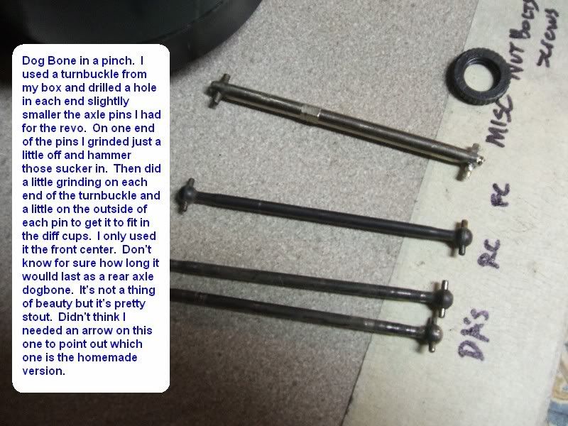

The dog bones seem to be a problem. For one staying in at times and also being weak. I haven't broken any yet but plan on getting around to it.
LS10 Dog bones<o:p></o:p>
6x84mm Drive Axles<o:p></o:p>
6x83mm Rear Center<o:p></o:p>
6x73mm Front Center
Stronger alternatives? Really depends on gettig the 7mm to fit into the cups.
<o:p>86230 7x86mm drive axles HPI MT2</o:p><o:p>
</o:p><o:p><o:p>86232 7x83mm HPI Nitro MT</o:p></o:p>
<o:p><o:p></o:p></o:p>

Axle Dog Bones.
The closest dog bones I found to the 6x84mm that are stronger are<o:p></o:p>
<o:p></o:p>
86230 7x86mm drive axles HPI MT2<o:p></o:p>
<o:p></o:p>
Has anyone tried to get these to work?
The 7x83mm would fall out like the current problems, but the 86mm is possible.
<o:p></o:p>
The additional 2mm length might not be a problem. I put about 1mm of fuel line or an shock o-ring in each cup to hold stock ones in. I was thinking about ordering some and seeing what could be done to get the 7mm dog bones to fit into the current axle/diff cups.
As far as CVD Lincpimp has tried some HPI cvd's but said they were no good.<o:p></o:p>

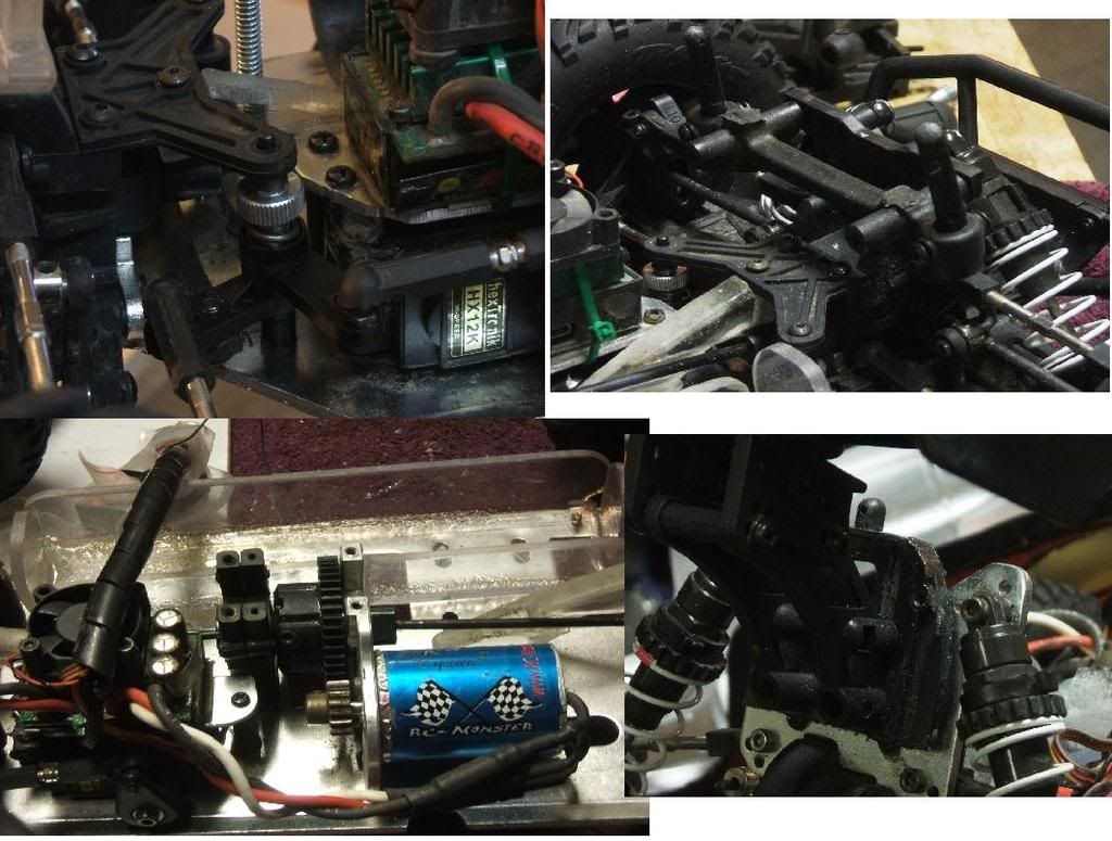

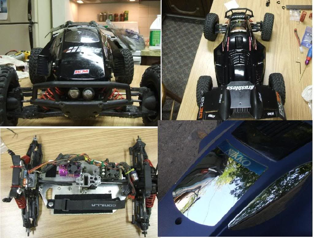

Here are some pics of my LS10 that I am selling. Not sure if they will help...
http://www.rc-monster.com/forum/show...142#post216142

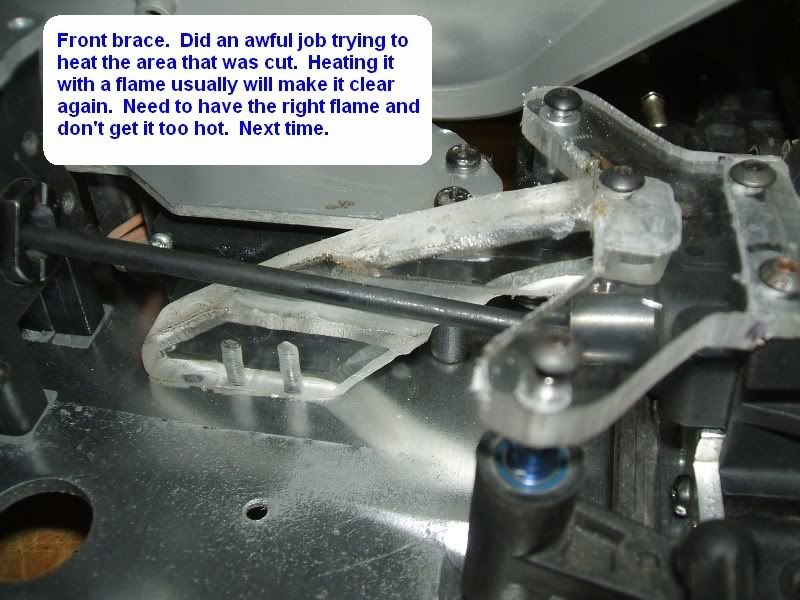

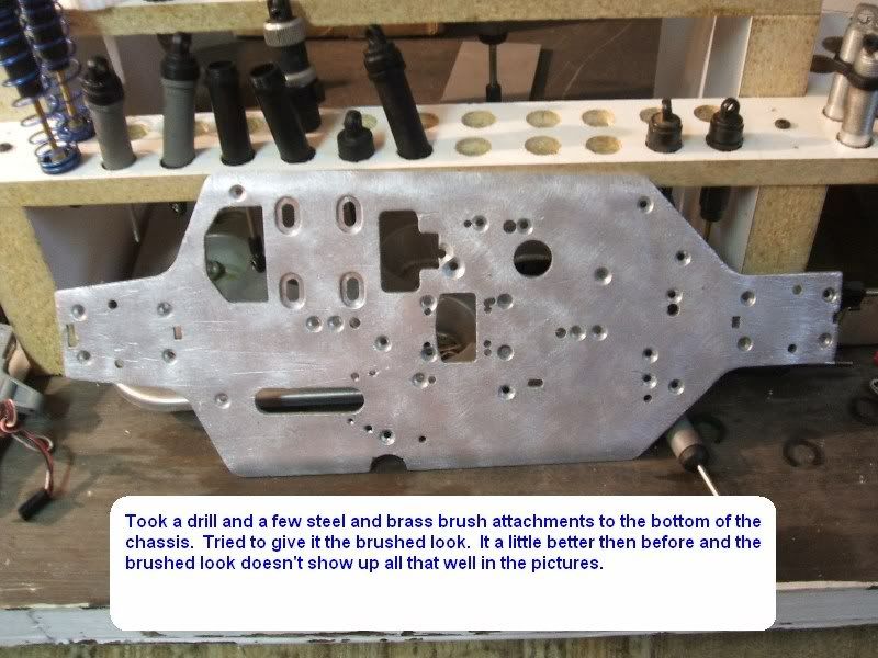

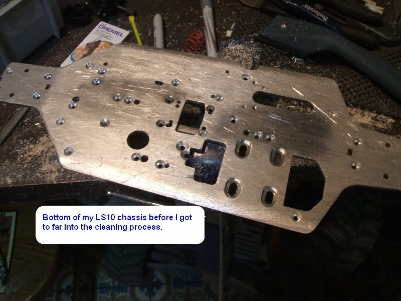

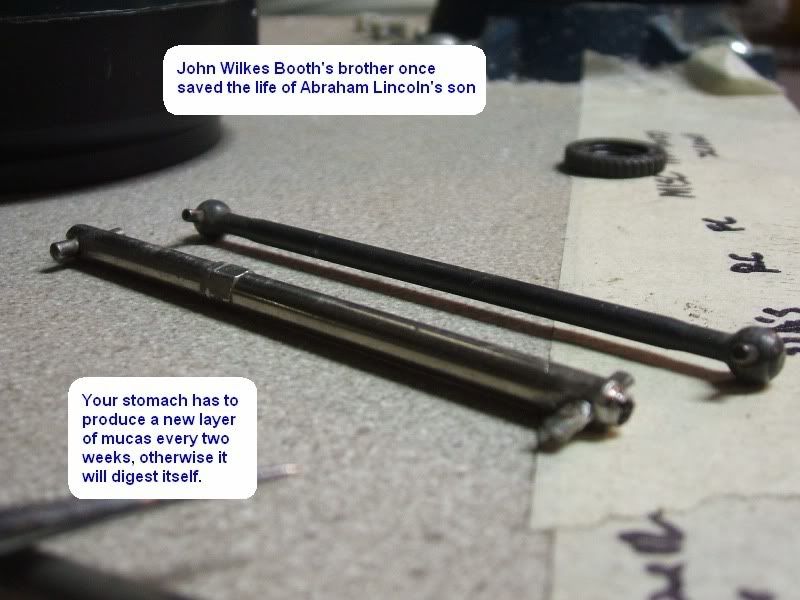

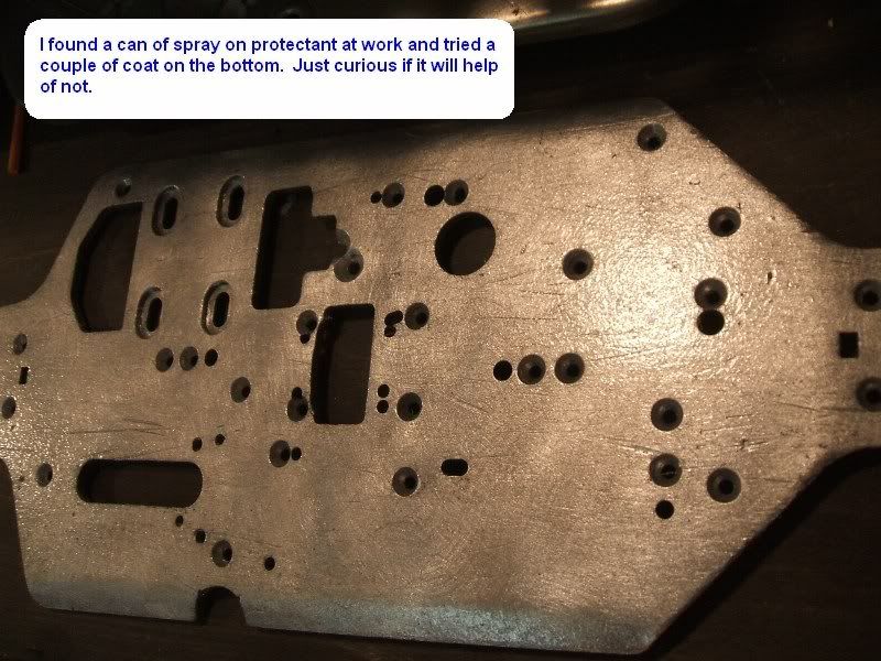

Had a feeling this was going to be one of those hot threads. If your gonna start something you better be ready to see it to the end.
Ordered some part to try out on the LS10. Got the rear hub set from the MT2 on the way and a couple of the 7x86mm dog bones to try out.
Found out the Monters Pirate was an 1/8 scale truck. Talked to a fellow at OFNA. I did find a Duratrax servo saver that I got to work. Sort of the spring that came with it it to tough to get on what I have and the spring I have is to soft. I will be cutting a leaf or so out of the duratrax spring to get it to fit. The part was the DTXC8850. Threw together some photos. They pretty much say it all. I have another servo saver I am going to try from associate coming in the mail with the dogbones. Will post what I find out with those part after I try them out.

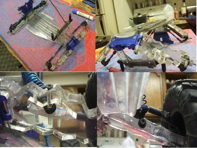

im still wondering on how well the servo saver system youve made up is gonna work out, should be nice once you get the right spring from the way it sounds. That tunrbuckle turned front dogbone is very crafty, i would have never thought of that......i wonder how well itd hold up, looks alot beffier than the stockers. what shocks and towers are you running? i also noticed your running pede body mounts excellent choice they should last forever. not really sure about the polycarb braces and stuff, they look fine and well made i just havent had much luck with the stuff.......
btw i dunno what happened to the thread with the how to mount a wing that i did it was fairly simple, ill keep an eye on the thread and voice my input even though i sold my LS10 to t-maxxracer32 im sure he'll enjoy it as much as me im just not using it much since about all me do is race anymore and there isnt a fair class i can run it in.
i still have my half completed extended chassis, shock towers, aluminum steering plate, and front and rear braces that i made for my LS10, ill be keeping these jsut incase i get the itch to do another LS10 or they start a mini truggy class at our track.

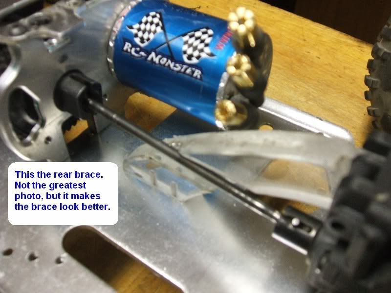

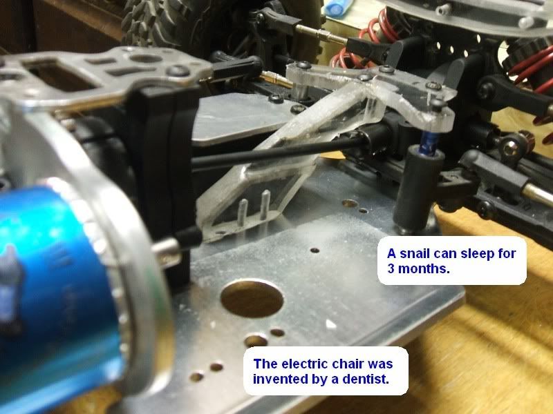

Man I'm sorry to hear you sold your LS10. Never seen anyone get one to fly and land as well as you.
I am hoping I find a servo saver that works pretty soon. Got a good stock pile of bellcranks building up from trying them. This one will not work until I get the stronger spring on it.
The shaft was my impatients. I did the center diff knowing the dogbones I ordered were not going to show up for a while. There wasn't any problem using it in the center drive. It doens't get the stress the rear axle one do.

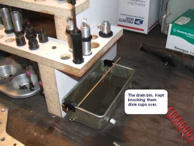

The shocks must look funny. They are my hybred of the traxxas big bore (long) for the rustler with some revo springs. I was bottoming out all the time until I put those springs on it. You know how heavy the little tanks can get. They are a I just got in a bunch of Jato springs to try out.

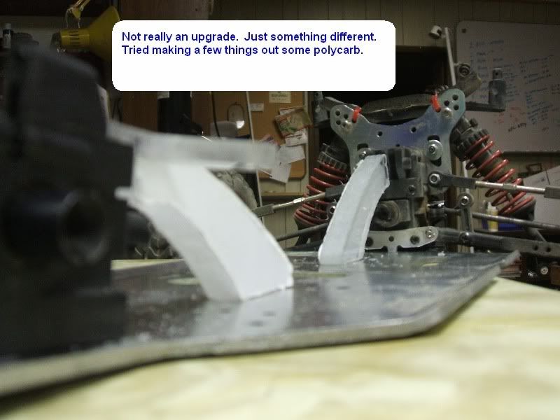

Will have to see about the polycarb. It's pretty tough but the part that hold the front bellcrank turned out pretty thin. Was making some other stuff out of polycarb. One thing led to another. Didn't plan on taking the LS10 apart but the screws just kept coming out. At one time I had a rustler that was made out of the polycarb. Tried giving the arms a different look. It held up for a long time. Still got the arms in a box except one rear broke last winter. It was close zero out when it broke. The chassis went through hell. It was like a freak accident. I put a Feigoa 12s on it and had it in the street for the first test run with no body. I didn't punch just gave it some throttle and bam! The thing flipped so hard onto its back it snapped it right where the tranny hooks up. Same place I keep breaking the stockers.
Have you had any problems with the center shafts at all? Has most of the breaking occurred on the rears?
Thanks rootar any input you can add would be great. Hope to see you flying a LS10 again.

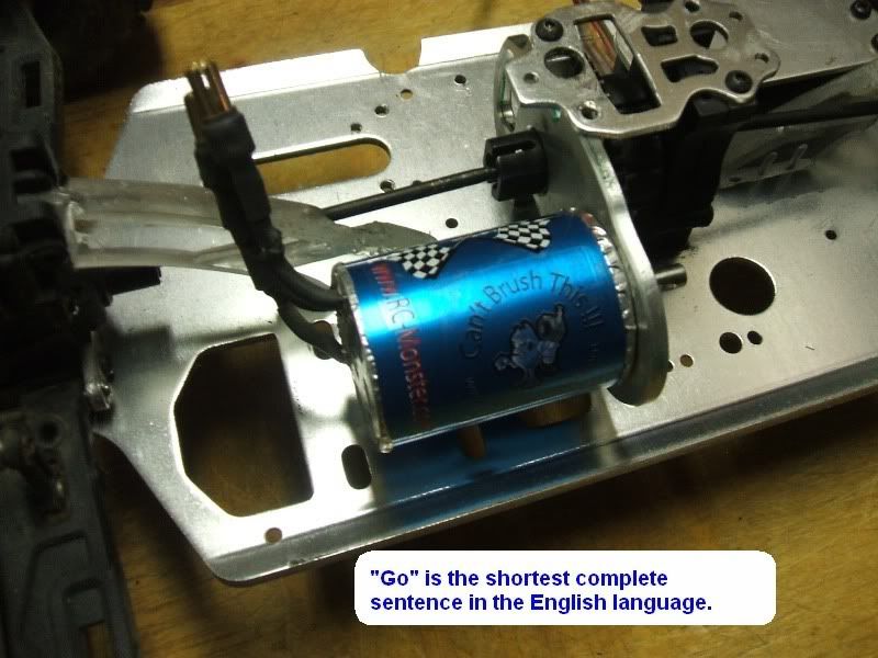

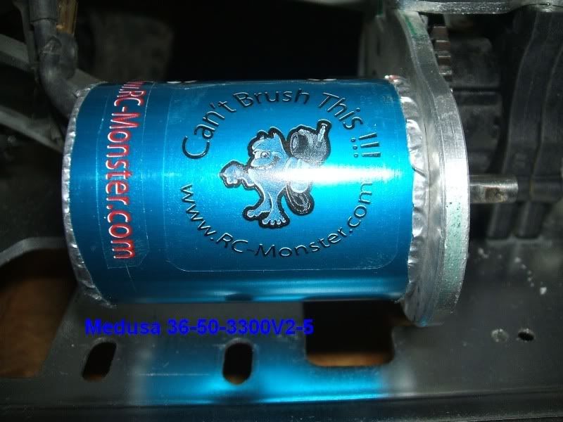

Now I need to go flip the motor mount and put the motor on the other side where it's suppose to be. Thought something wasn't right when I put it back together.

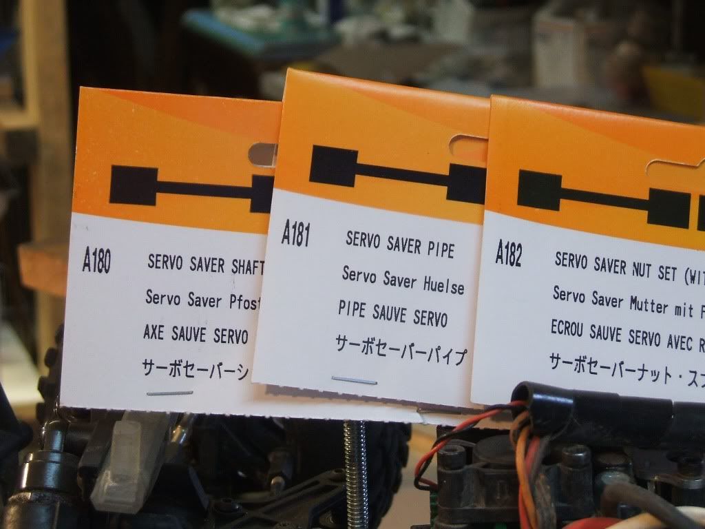

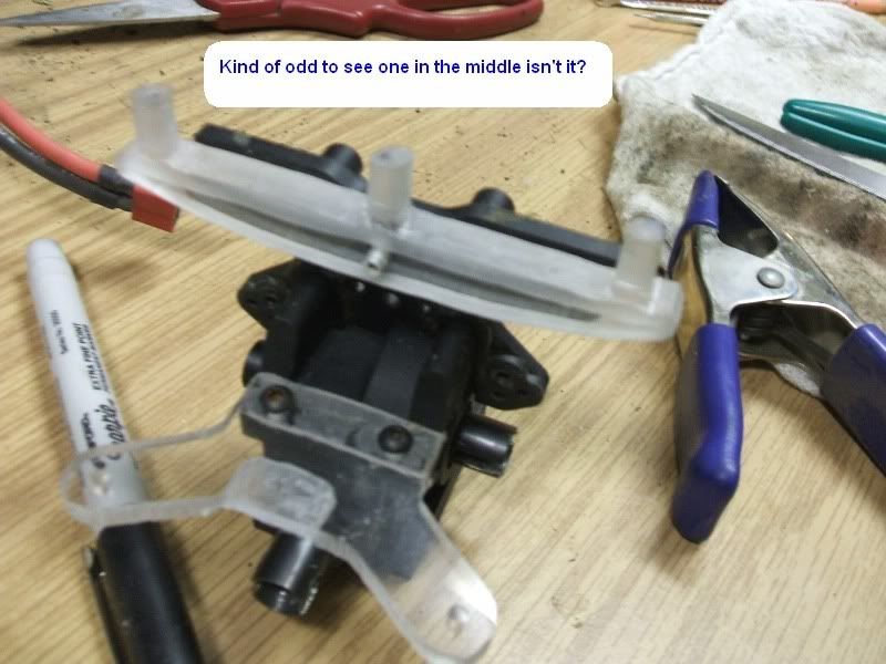

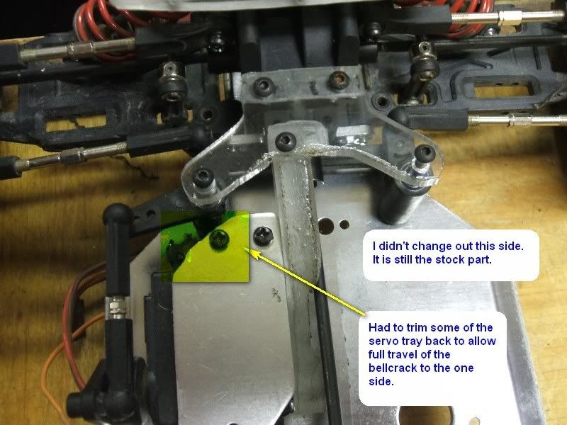

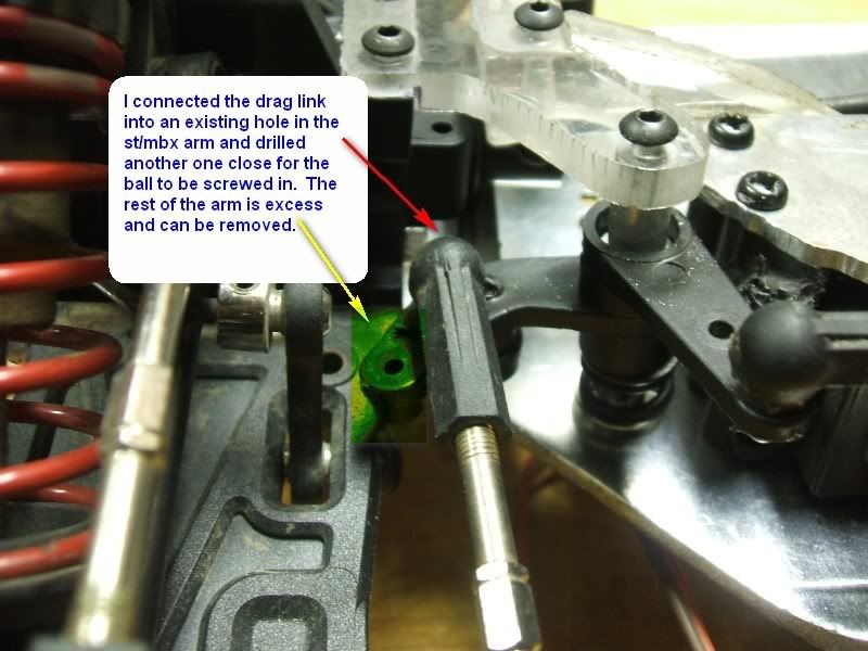

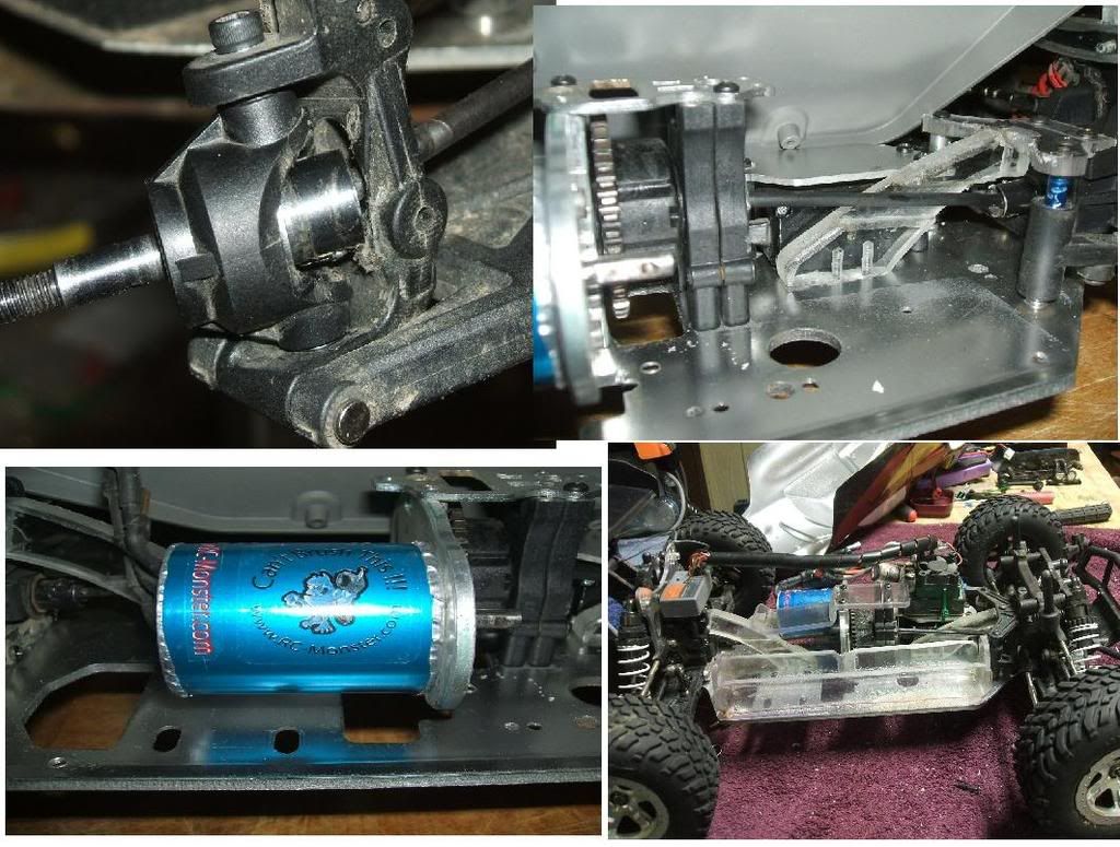

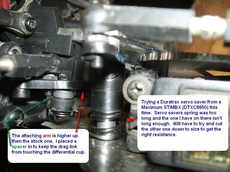

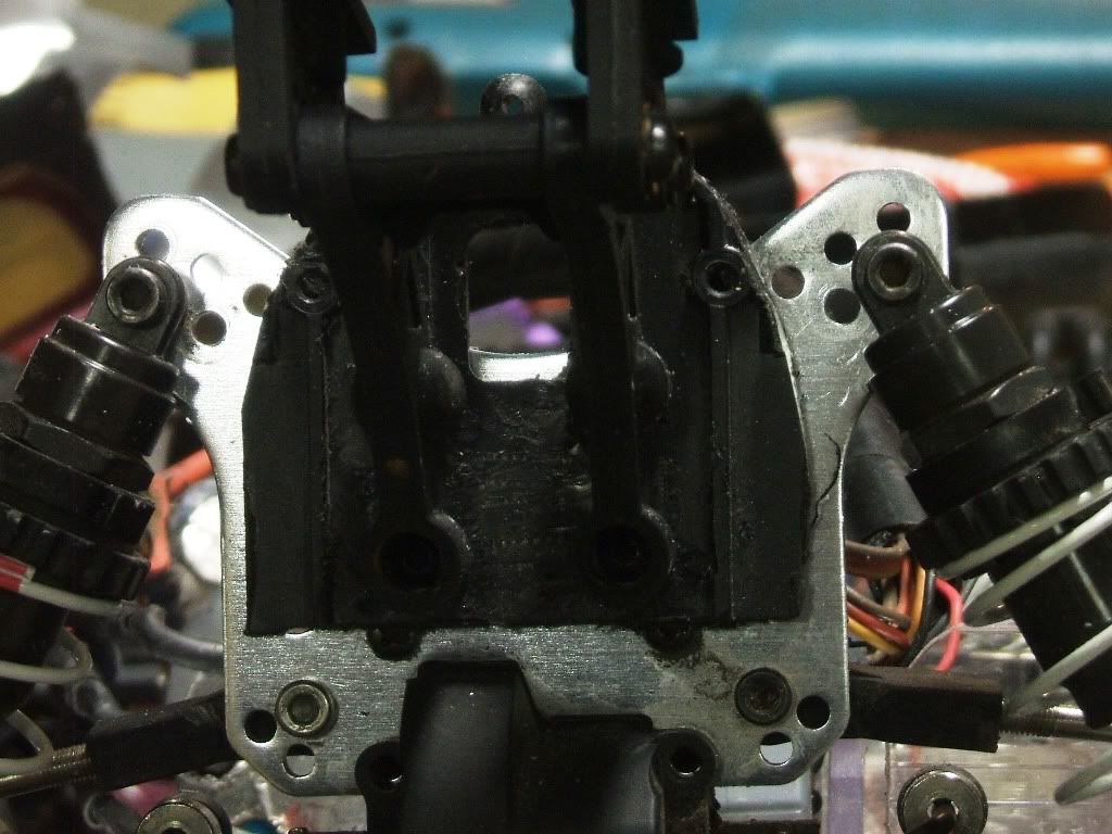

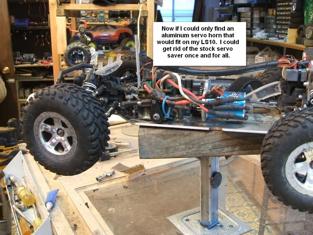

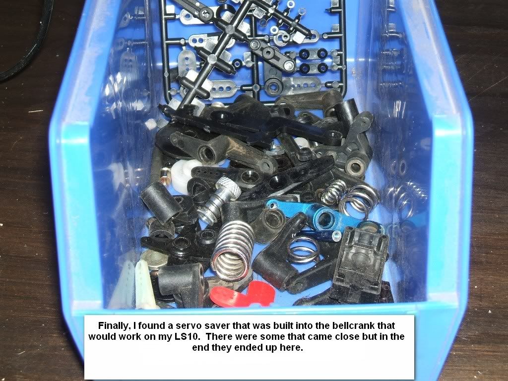

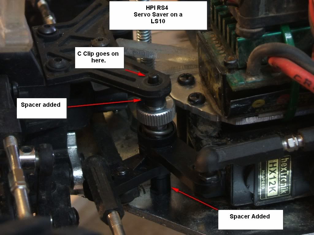

UPDATE: Servo Saver in the Bellcrank found.
All previous servo savers failed to make the grade. Springs were to week, too many mods needed, or just plain broke on first outing. I am glad to annouce we have found a winner.
The comment in the last picture is just a joke. I have an aluminum servo horn that should fit that servo.
Stay tuned for a possible center differential with a plastic spur to help you run silent.
I'd like to give credit were credit is due. I was told the RS4 servo saver would work on a 1/10th scale some time ago and several different tries earlier.
http://www.rc-monster.com/forum/showthread.php?t=14856
At the time I didn't realize how many RS4's there are and the parts I ordered from tower for an RS4 servo saver were not the correct RS4 parts that were needed. That led me to believe that I was given the wrong info. I wasn't given the wrong info. I just didn't ask enough questions. After a full circle I ended up back at HPI RS4 once I realzed there were more to choose from. I did learn a bunch in the process of finding the right servo saver so the process was worth it.
To add further embarrassment to myself. You'll may notice in the thread I linked to above. The information given to me HPI RS4 servo saver was also a link to what was needed. Well most of the links I was accustome to see looked more like this one http://www3.towerhobbies.com/cgi-bin...aver&search=Go. So I didn't catch that part either.

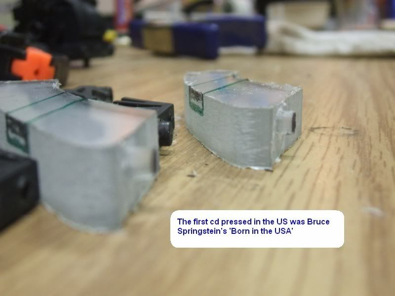

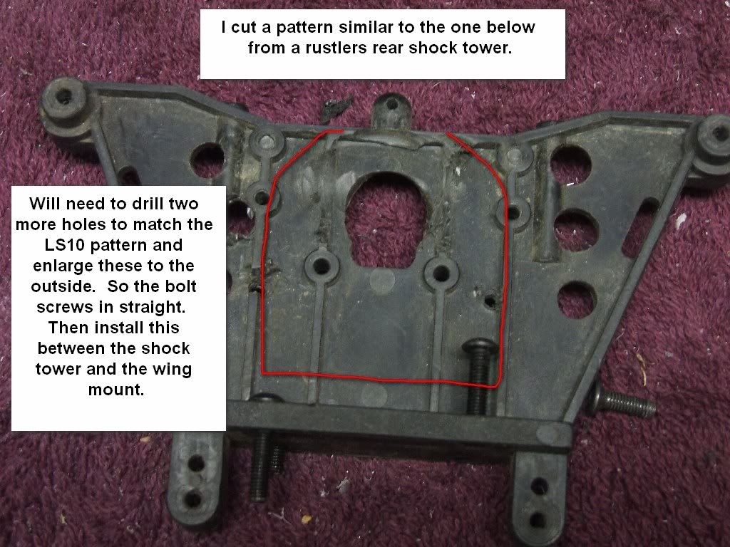

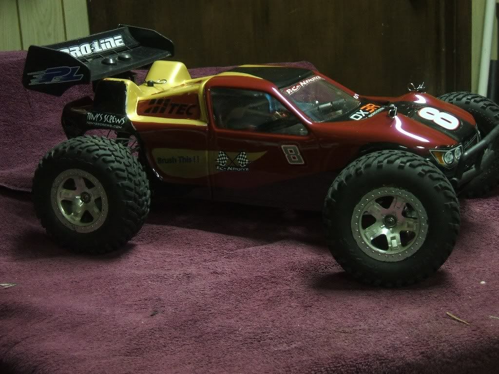

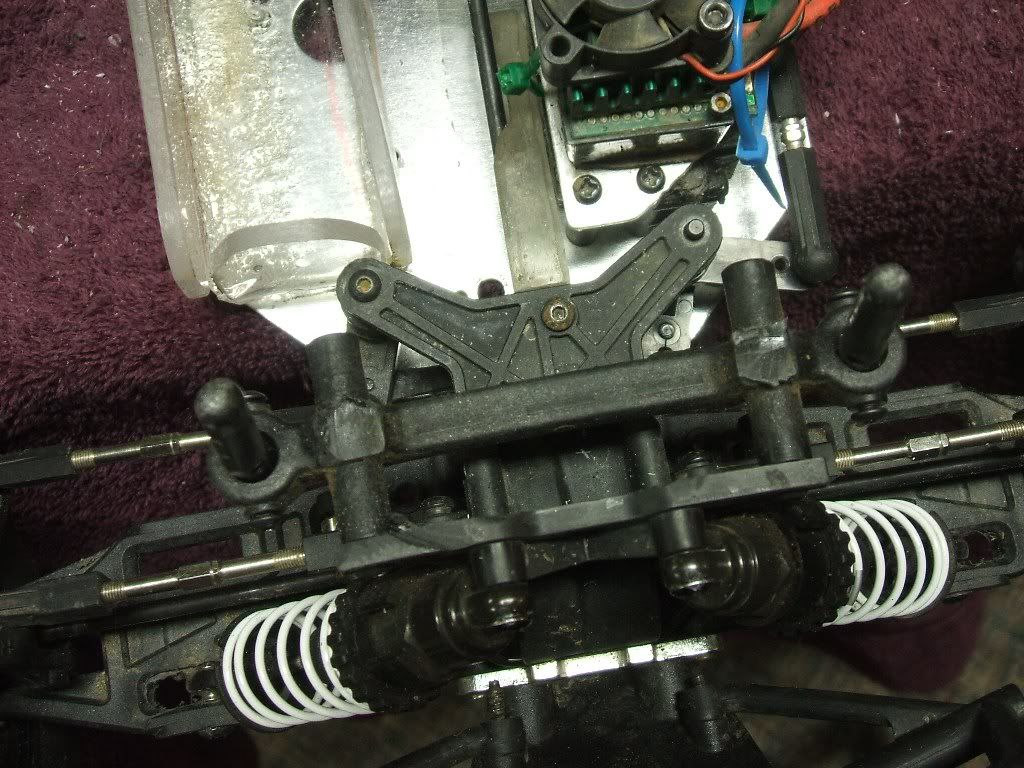

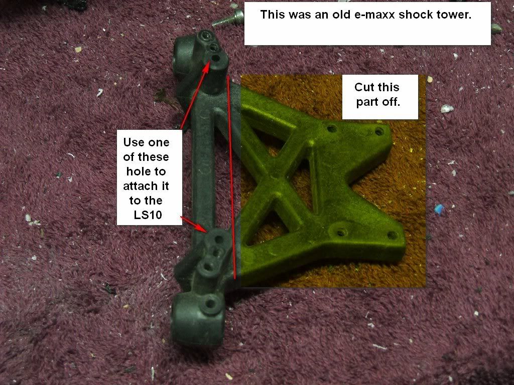

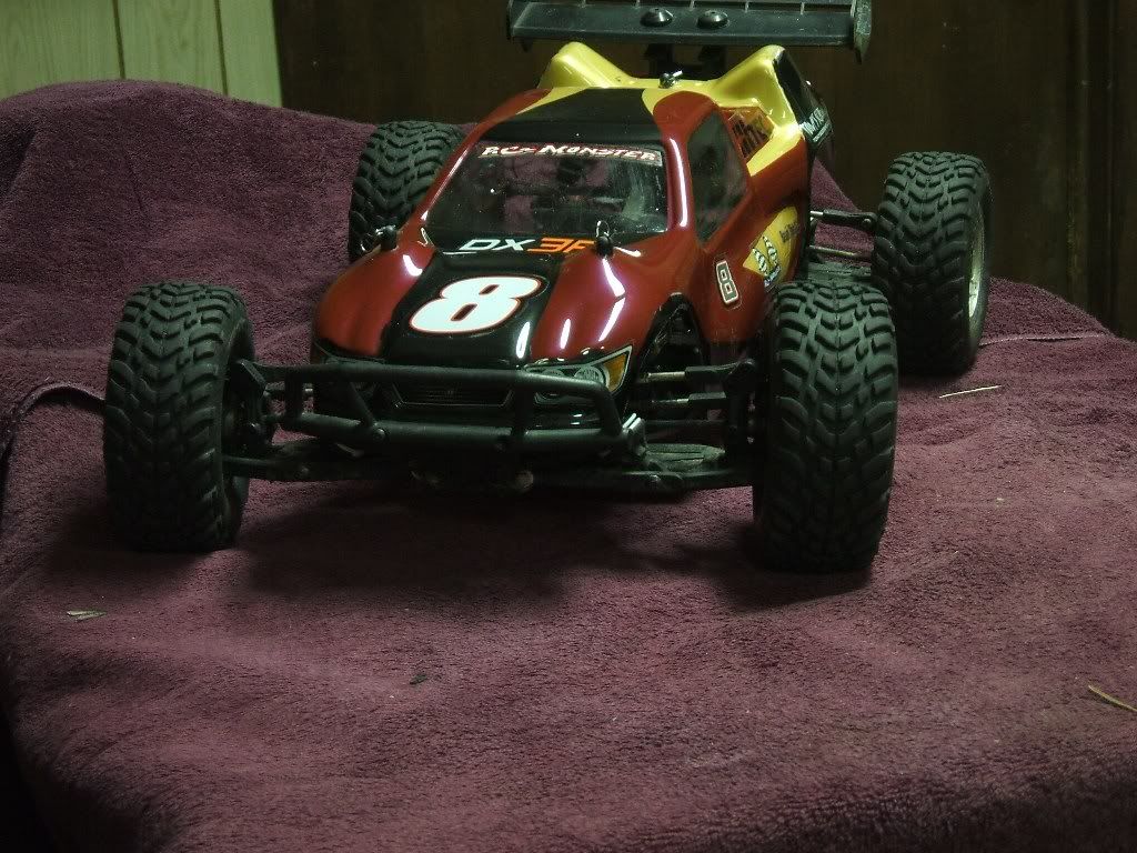

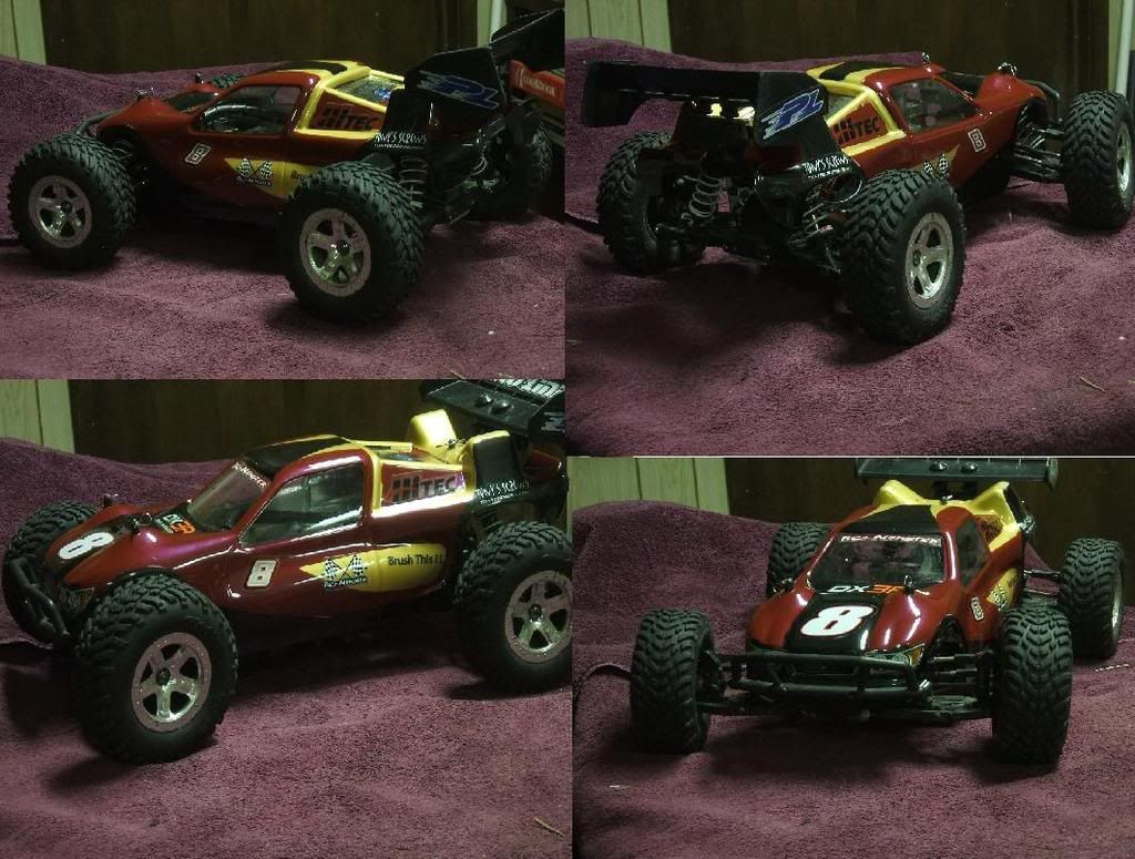

Finally got around to painting the new body for my LS10. When went to install the stock body mounts I found the post were broken off and were too low to work with the body. So this is something that I came up with that works with the body I painted. May not work for you body but it might help spark and idea of something that will work.
For the front I used and older emaxx shock tower and cut in half. Then attached it to the LS10s front tower with the existing holes. Found some post and tightened them down it it.
For the rear I used the rustlers tower and cut a section out of it. Lined it up withth the holes on the rear tower for the LS10 Then I sandwiched it between the wing mount and shock tower. The body I have will work using just a single mount in the rear.
